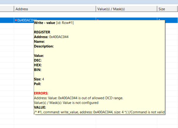

I cannot use on the DCD tool an address that should be allowed.
It does not come up on the list of registers, but also blocks the manual entry, although the 1064RM specifies it as a valid address to be used:
1064RM page1064RM pageConfig toolConfig tool
Any information on why there is a restriction?

In general, I replicated the error and I'll report this error to MCUXpresso config tool team in the next round of field trial.
Thanks again.
