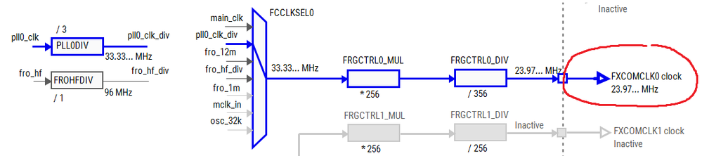

Hi there,
for using the serial interface, I configured Flexcom 0 clock to 23.97 MHz, see here:
Now to initialize USART0, I think I should call
USART_Init ( USART_Type * base,
const usart_config_t * config,
uint32_t srcClock_Hz
The last parameter is "USART clock source frequency in HZ." (see docs).
I guess I should pass FXCOMCLK0 (in Hz) to correctly initialize the interface.
You don't want me to type this value in, do you? That would be 🤦‍
So how do I programatically retrieve this value?
I tried
CLOCK_GetFlexCommClkFreq(0);
but this resulted in 330 033 which is clearly not the value I need (what is this function returning, anyway?).
Cheers
Dan

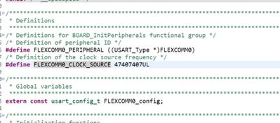

ZhangJennie
HI
There is defect in clock get frequency functions. With below code, change temp type as float.
uint32_t CLOCK_GetFlexCommClkFreq(uint32_t id)
uint32_t freq = 0U;
float temp;
freq = CLOCK_GetFlexCommInputClock(id);
temp = (SYSCON->FLEXFRGXCTRL[id] & SYSCON_FLEXFRG0CTRL_MULT_MASK) >> 8;
return (uint32_t)(freq / (1U + ((temp) / ((SYSCON->FLEXFRGXCTRL[id] & SYSCON_FLEXFRG0CTRL_DIV_MASK) + 1U))));
You will also find in peripheral.h, FLEXCOMM0_CLOCK_SOURCE  automatically changes to the right flexcomm0 clock source after code generation.
/* Definition of the clock source frequency */
#define FLEXCOMM0_CLOCK_SOURCE 47407407UL
Have a nice day,
Jun Zhang

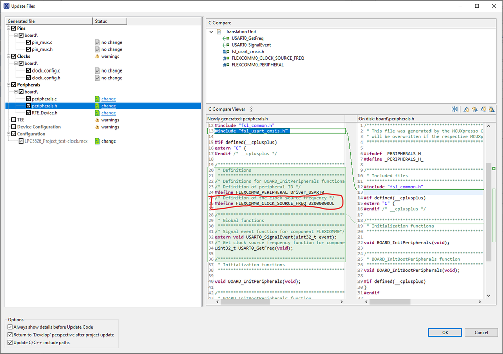

danielholala
Senior Contributor II
That code change fixed CLOCK_GetFlexCommClkFreq() and thus my issue. Thank you for your support.
Just a quick note regarding your comment regarding "FLEXCOMM0_CLOCK_SOURCE". I could not find this definition in any of my projects. What I found was "FLEXCOMM0_CLOCK_SOURCE_FREQ"
However, this definition is only available after one uses the Peripherals tools to configure, e.g., USART0, see screenshot. In other words, if one does not use Peripherals tools this definition is not available. Just a thought, maybe the clocks tool should add this definition instead of the Peripherals tools.
11,283 Views

ZhangJennie
Maybe we use different versions. anyway, I think they are same thing despite the name. this is generated by peripheral tools
11,716 Views
danielholala
Thanks for confirming that the definition for clock source frequency is only available after using Peripheral tools.
The name of the definition may well vary over tool version. My versions are as follows:
  •  MCUXpresso IDE v11.4.1
  • Clocks Tool Version: 8.0.0.202109031454
  • Peripherals Tool Version: 10.0.0.202109031454
  • Pins Tool Version: 10.0.0.202109031454
(extracted from Help > About MCUXpresso IDE)
11,701 Views
ZhangJennie
Ok. my version is older.
