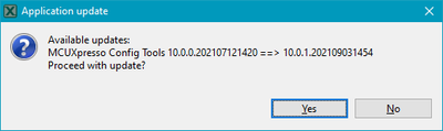

Hello @tomasklir,
I use almost the latest version:
and I just updated.
I tried various approaches so I don't exactly recall what I did, but I have a file named MIMX8M-EVK-REV-B.mex which has routing (not done by me), but can't remember where got it from.
It doesn't contain identifiers/labels.

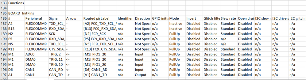

EdwinHz
Hi @WillemGruter,
The first part of the csv_output.csv file provides a table of all the pins in a package as well as all of their supported functions, similar to what you would find in the datasheet of the MCU. In this example of a LPC54608J512ET180, pin A1 has the name CAN1_TD, and can be set up as a GPIO pin with name PIO0_1, as a FLEXCOMM pin with name FC3_CTS_SDA_SSEL0, as a CTIMER pin with name CTIMER0_CAP0, etc.
Then below this table, there is another section that describes only the pins that are routed as well as their respective configurations. In this case, I enabled some ADC0, CAN1, DMA0, FLEXCOMM0 and FLEXCOMM9 pins and this section describes all of the information of each routed pin for their specific function.
I hope this helps,
