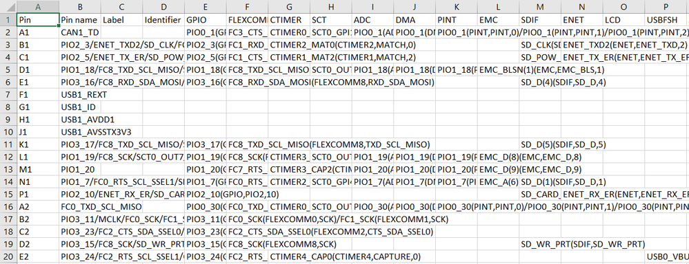

We have a product (IO Checker) to verify that an FPGA is correctly connected on a custom board. (Comparing FPGA pin reports with the schematic/board netlist in an intelligent way)
We would like to do the same for micro processors and for NXP the csv_output.csv from the MCUXpresso-Config-Tools seems a viable solution. However the contents of this file is not a 100% clear to me.
Is there additional information I get get, or can you bring me in to contact with a NXP engineer would could tell me more ?

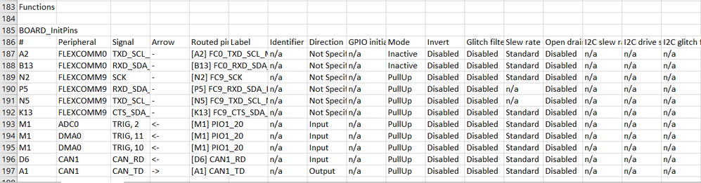

when you create a new configuration for processor, labels and identifiers are empty. And they stay empty even after routing. The user has to set them manually.
When a new configuration is created for a board, it's a different scenario. Board configurations are pre-configured by NXP, including labels and identifiers. Routing/unrouting a pin should not affect its label nor identifier which you can also see in Pins view.
William obviously used a new configuration for processor. That's why labels were empty in his case.

The first part of the csv_output.csv file provides a table of all the pins in a package as well as all of their supported functions, similar to what you would find in the datasheet of the MCU. In this example of a LPC54608J512ET180, pin A1 has the name CAN1_TD, and can be set up as a GPIO pin with name PIO0_1, as a FLEXCOMM pin with name FC3_CTS_SDA_SSEL0, as a CTIMER pin with name CTIMER0_CAP0, etc.
Then below this table, there is another section that describes only the pins that are routed as well as their respective configurations. In this case, I enabled some ADC0, CAN1, DMA0, FLEXCOMM0 and FLEXCOMM9 pins and this section describes all of the information of each routed pin for their specific function.
