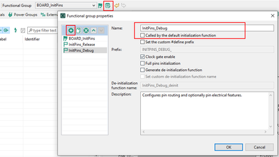

Hello @_Ferrari_
Yes.
Alice
3,659 Views
Petr_H
You can use multiple functional groups in the Pins tool to define alternative pin routings and generate separate functions.
Open the functional groups dialog using the icon on the toolbar (see the following picture) and
add two function groups. For example InitPins_Release and InitPins_Debug.
Ensure that you uncheck the "Called by the defaut initialization".
Then, select the InitPins_Debug functional group and add there routing needed at debug time and similar way for the release case.
After you update the generated code, you the call the generated functions in the main module like this:
#ifdef DEBUG
InitPins_Debug();
#else
InitPins_Release();
#endif

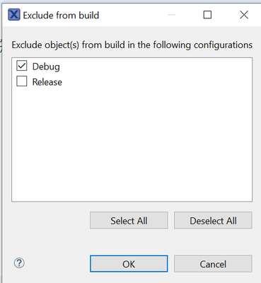

Hello @_Ferrari_
You can put the configuration code in one file, then enable or disable for Debug and release.
For example configure the pins as ADC function in adc_pin.c, only enable it in Release, exclude it in Debug,  this file only works on release . steps as below:
Alice
3,715 Views
_Ferrari_
Contributor V
Dear @Alice_Yang
Thank you fro your answer
Ok, I understand. It means that, in my case, I have to have two files:
fisrst file named i.e. PIN_MUX_DEBUG.C excluded from build in Release mode
second file named i.e. PIN_MUX_RELEASE.C excluded from build in Debug mode
Of course in the file PIN_MUX_DEBUG.C CPU pins 12 and 13 are defined as SWDIO and SWCLK
In the file PIN_MUX_RELEASE.C CPU pins 12 and 13 are defined as ADC0:CH2B and ADC0:CH1B
Is it correct ?
thank you very much for your help and cooperation
best regards
3,632 Views
Hello @_Ferrari_
Yes.
Alice
