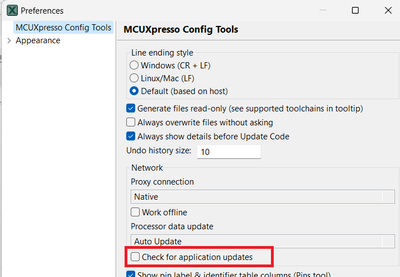

I used to use version 12, but it automatically upgraded to version 13. However, I still want to use version 12. How can I roll back this version.

HI Libor,
Thank you for your reply! In fact, I did not directly use Config Tools. I am using S32DS3.5, so I don't know where to turn off automatic updates

liborukropec
once Config Tools are upgraded, there's no way to revert back. The upgrade is not automatic, it is confirmed by the user.
To roll back you have to uninstall the Config Tools and install again. To make sure you won't update again, you can disable the check for a new version in menu "Edit | Preferences":
