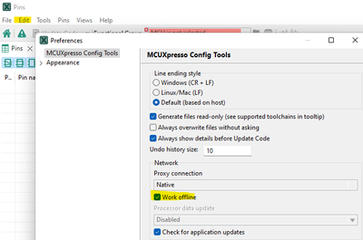

currently there's no direct CLI argument, you can put preferences into the docker image with offline option turned on:
then you can find the preference stored in the $HOME/.nxp/MCUX_Tools/11.0/preferences/.preference.storage4.properties
offline=true
and this file you can put into your docker container.
Another option is to overwrite the server from which the data is downloaded, but it will pollute the error log with false errors.

Maybe I'm doing something wrong but setting "offline=true" to ".preference.storage4.properties" file didn't seem to block Config Tools to fetch processor data from internet. I couldn't get the logging improved either by tweaking "java.util.logging.ConsoleHandler.level = WARNING".
Anyway, the root cause for original issue seems to be clear: Config Tools fetches processor data from internet when we load the .mex configuration file and sometimes the processor data is outdated due to network issues. And we have a solution to copy-paste specific content into $HOME/.nxp/mcu_data_v11 folder and then block Config Tools network access with other tools.
I think this is enough for us and discussion could be closed. Thanks for the help!
