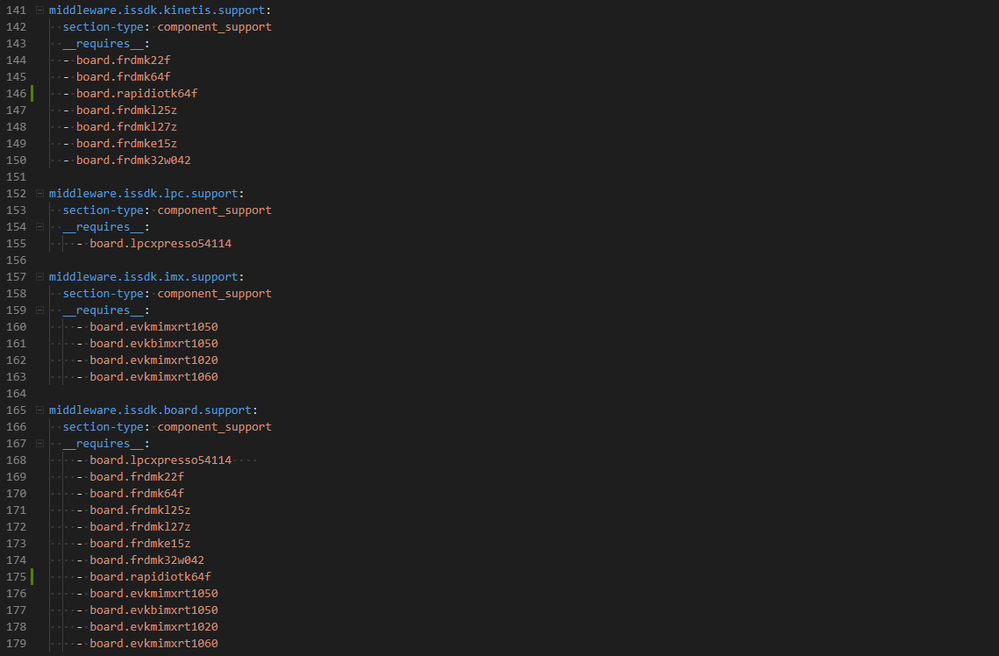

I am having some issues when trying to add a component from the IS-SDK (middleware.issdk.drivers.gpio_kinetis) to a new board SDK I am working on. I had a similar issue when trying to add the emWin component. The issue was cause by a missing "__requires__ board.rapidiotk64f". I've added the missing requirement tho the add_issdk_utils.yml :

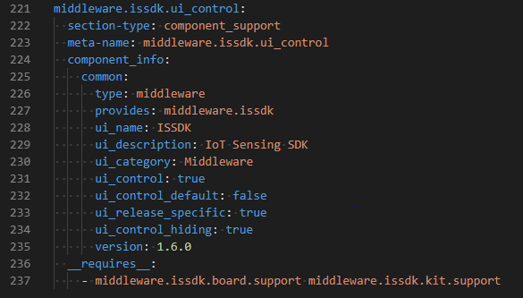

But it still didn't work. After further reviewing the __requires__ I saw that I need the ui_control that needs the middleware.issdk.kit.support. So my first attempt was to add a rapidiotk64f kit but I failed. The solution that I came up with was to modify the __requires__ field of the ui_control form :

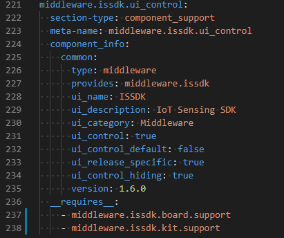

to
So new because the ui_control requires only board.support OR kit.support it works fine.

in _requires_ attribute:
  • list of required components on a single line represents list of all that must match at once (e.g. AND logic for all)
  • list of lines represents OR logic, e.g. at least one of them must be satisfied
Currently OR logic is not supported in the MANIFEST format (better to say it is supported for CORES only), so it is not recommended to use in YAML.
Holt Sun should answer, whether this is supported for the 'component_support'. This part is not processed by manifest generator itself, so I'm not sure here.
Marek
