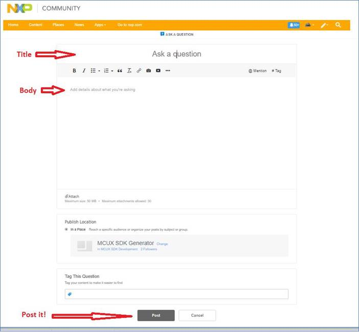

  1. Go to the MCUX SDK Generatorcommunity sub-space
  2. Check that there is not any post about your problem already
  3. Create a new question post or any other available post type (according to a purpose of your message)pastedImage_5.png
  4. Fill in the form
    1. Fill in the title of the message
    2. Fill in the body of the message
    3. You can add attachments
    4. Post it
