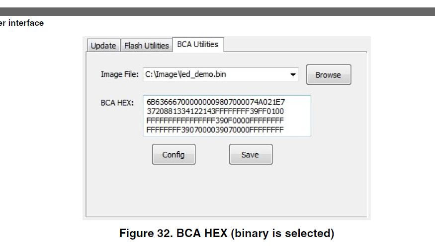

   Please use the kinetisFlashTool in the KBOOT2.0 do modify the BCA data.
   Please read Kinetis Flash Tool User's Guide.pdf for more details, this document folder:NXP_Kinetis_Bootloader_2_0_0\doc
   KinetisFlashTool folder:NXP_Kinetis_Bootloader_2_0_0\bin\Tools\KinetisFlashTool\win

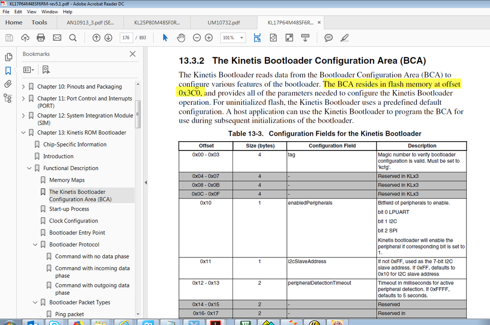

how to understand " The BCA resides in flash memory at offset0x3C0 from the beginning of the user application "?

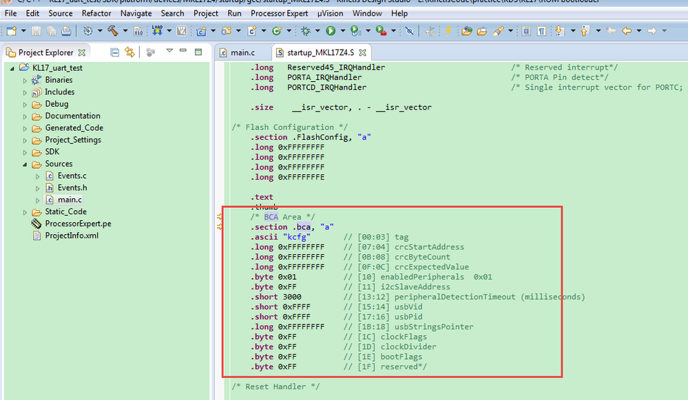

does the bin file of the user's application contain the BCA data?  if so, we should put the bootloader_config.c that created

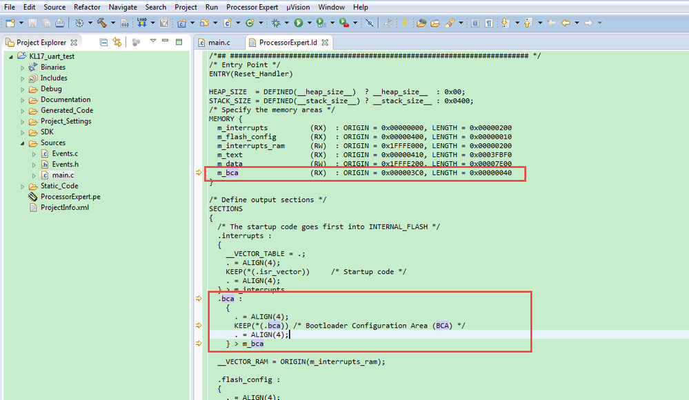

kerryzhou
Hi du gg,
    BCA are have the fixed address, you can find it from the chip's reference manual, but take care, just those chip have the ROM bootloader contains the  BCA area:
     So, you can create a project which start from flash address 0, then add the BCA area.
Build it, generate the .bin file, you will build the BCA by your self.
I also attached the KDS project for BCA, just for your reference.

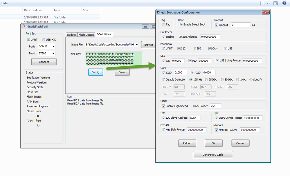

Another way, you also can import your application code which didn't have the BCA data before, then import it to the BCA area int the kinetisFlashTool, then config it, and save it:
Then, check your original code, you will find your BCA area(0X3C0) is modified.
Wish it helps you!
