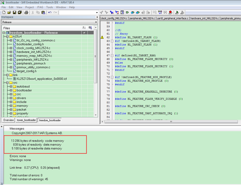

    I have checked the KBOOT2.0 code, if just use the UART, and in the release mode, the code size is :
It's about 19K, so if you are using the 64K chip, you still have about 45Kflash for your app.
About the build error, it should be the IAR newest version problem, I build the IAR with lower version(7.80), it has no problem, but I tried the IAR V8.22 also have problems, because the official code also based on the IAR7.x. the new IAR version may changed some ide level's lib folder, now do you mind to use other IDE, eg MDK, or KDS?
