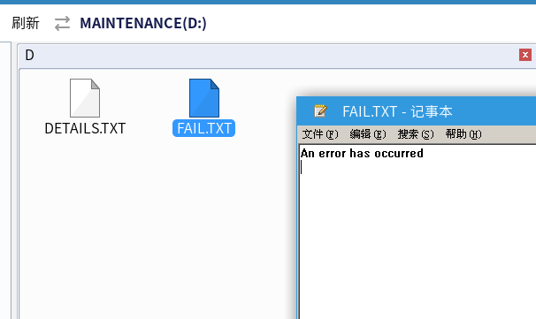

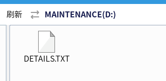

but I pull the mcuboot.bin into the disk MAINTENANCE (under bootloader upgrade mode),there has  an error. The mcuboot
cannot burn into it.
before burning
is burning
after burning
How can the mcboot burn into the frdm_k64f board as bootloader?

maureen
mcuboot is for OTA upgrade and doesn't replace the mbed bootloader. The mbed bootloader runs on the K20 OpenSDA MCU, whereas mcuboot runs on the K64 target MCU.
