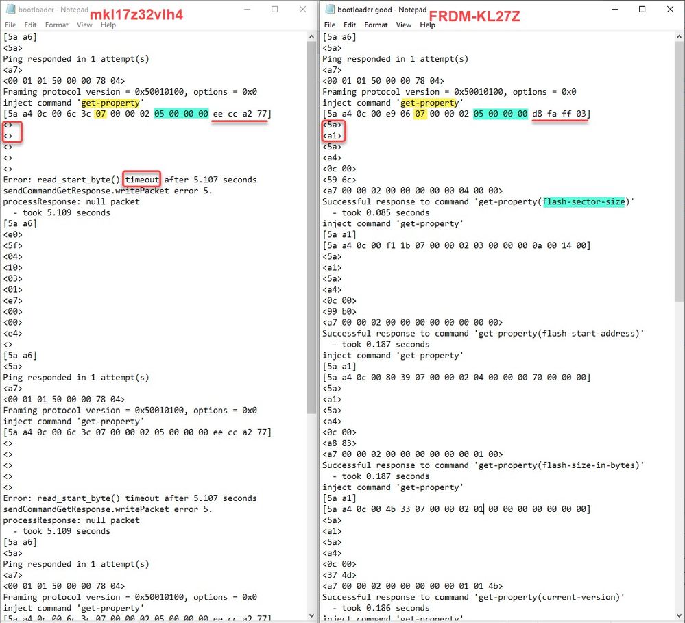

hi, using KinetisFlashTool can´t connect with mkl17z32vlh4 ROM boot, using UART. I get the same behaviour with a custom host.
this is the log of KinetisFlashTool:
[5a a6]
<5a>
Ping responded in 1 attempt(s)
<a7>
<00 01 01 50 00 00 78 04>
Framing protocol version = 0x50010100, options = 0x0
inject command 'get-property'
[5a a4 0c 00 6c 3c 07 00 00 02 05 00 00 00 ee cc a2 77]
Error: read_start_byte() timeout after 5.107 seconds
sendCommandGetResponse.writePacket error 5.
processResponse: null packet
- took 5.109 seconds
[5a a6]
<e0>
<5f>
<04>
<10>
<03>
<01>
<e7>
<00>
<00>
<e4>
[5a a6]
<5a>
<a7>
[5a a6]
<5a>
<a7>
Error: read_start_byte() timeout after 5.106 seconds
- took 5.107 seconds
[5a a6]
<5a>
<a7>

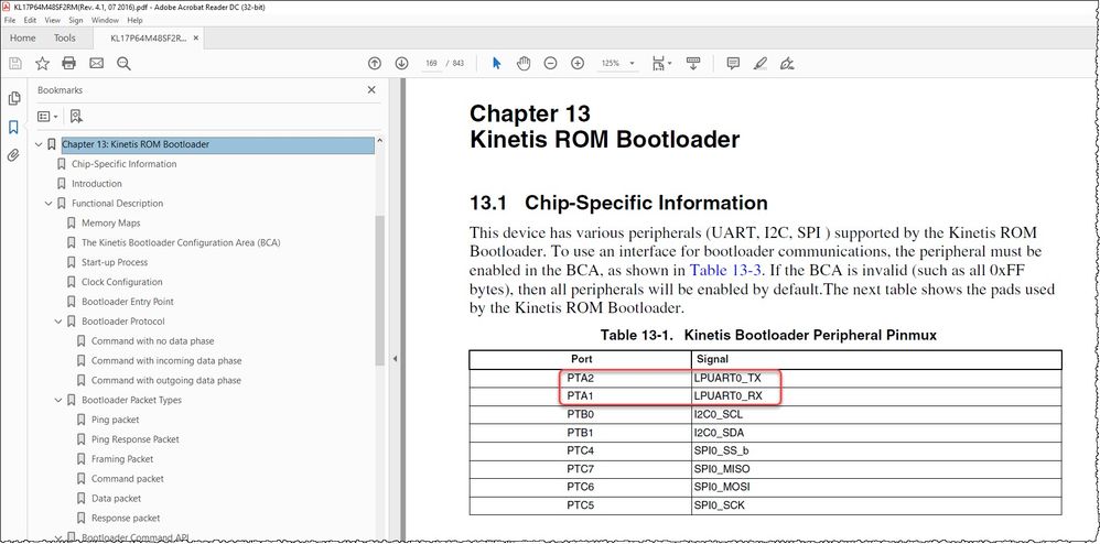

Hi marianoT,
Please check if PTA1 and PTA2 are connect. These two pins are the default UART pads used by the Kinetis ROM Bootloader.

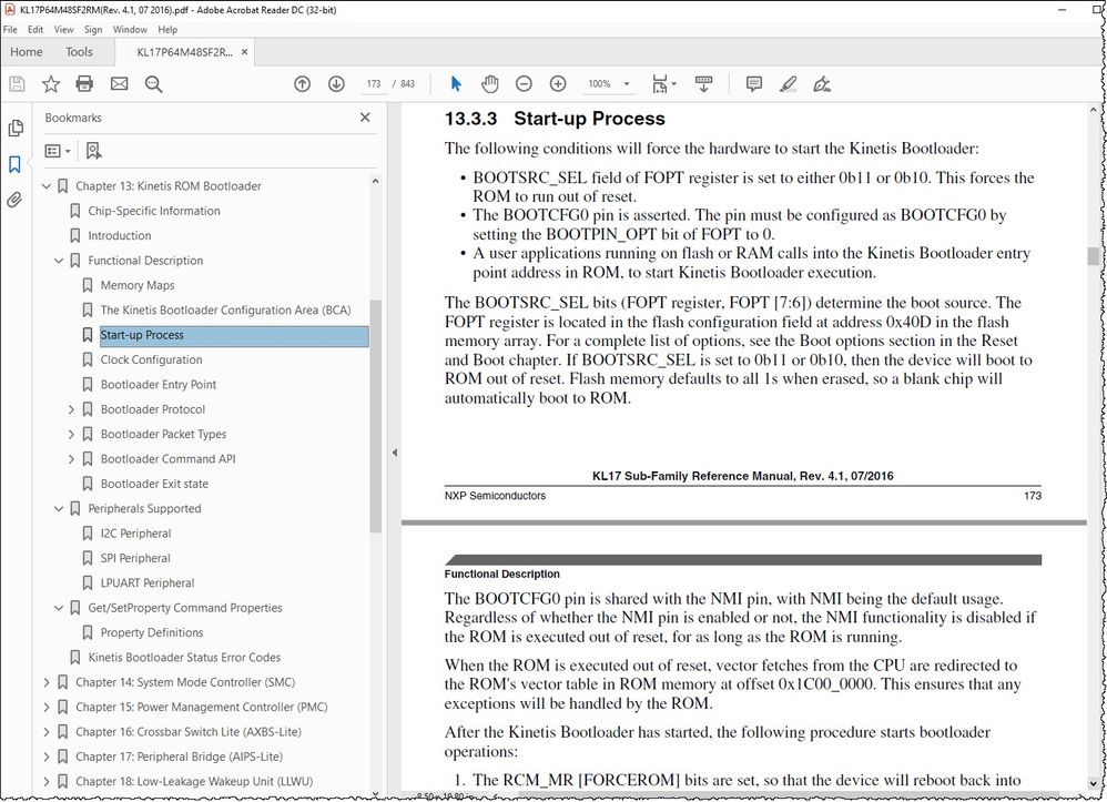

Press PTA4(NMI_b) pin before power on, then click the Connect button on KinetisFlashTool.

According to the "Table 5-2. GetProperty Command Packet Format (Example)", Memory ID should be 0x01 for internal flash. But I don't know why it send 0x77a2ccee.
By compare the log of FRDM-KL27Z(0x03fffad8), this is the only difference.
The FRDM-KL27Z is able to successful response to command 'get-property(flash-sector-size)'
But your KL17 did not send back ACK.
