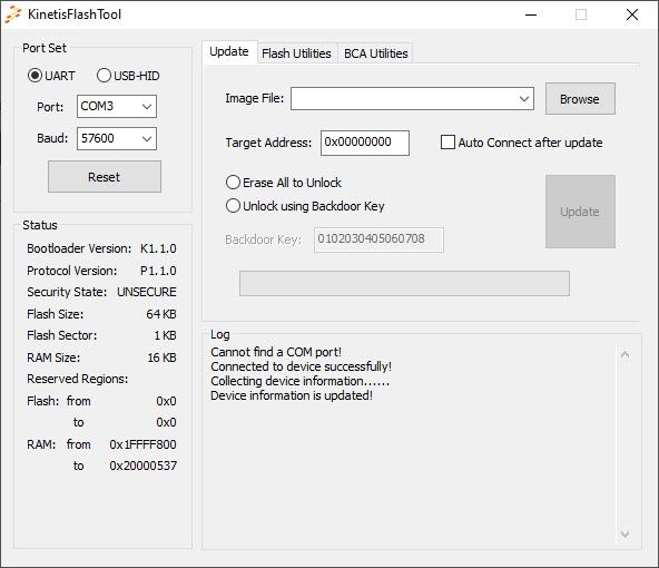

hi, using KinetisFlashTool can´t connect with mkl17z32vlh4 ROM boot, using UART. I get the same behaviour with a custom host.

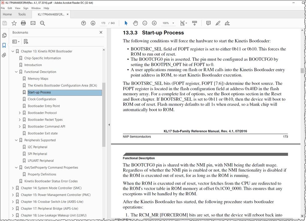

Please check if PTA1 and PTA2 are connect. These two pins are the default UART pads used by the Kinetis ROM Bootloader.
Press PTA4(NMI_b) pin before power on, then click the Connect button on KinetisFlashTool.

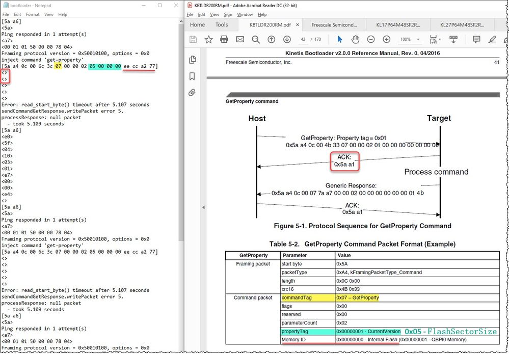

Robin_Shen
Sorry for my last reply!
According to the "Table 5-2. GetProperty Command Packet Format (Example)", Memory ID should be 0x01 for internal flash. But I don't know why it send 0x77a2ccee.
By compare the log of FRDM-KL27Z(0x03fffad8), this is the only difference.
The FRDM-KL27Z is able to successful response to command 'get-property(flash-sector-size)'
But your KL17 did not send back ACK.
