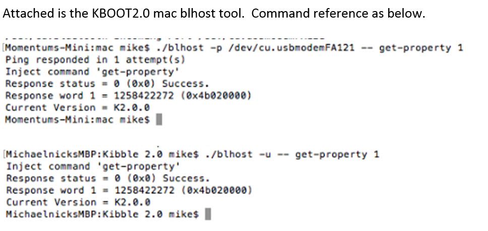

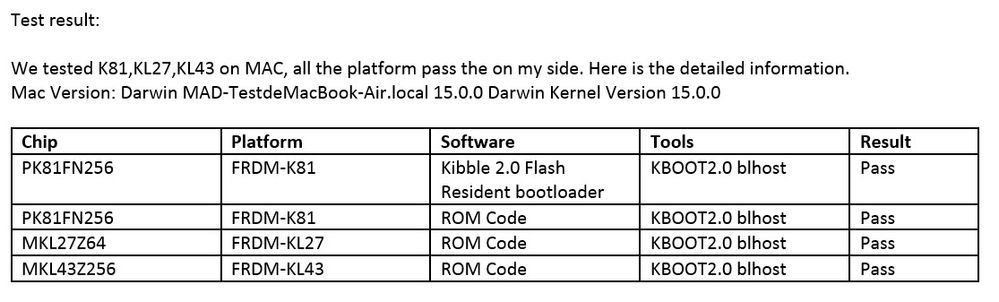

Please check Kinetis product team feedback:
I also attached the KBOOT V2.0 blhost mca tool for your reference.
The related command reference below:
Wish it helps.

Thank you for your reply, Ma Hui!
We've just checked blhost with the latest OSX and I can confirm that it does work as expected.
Have a nice day!
