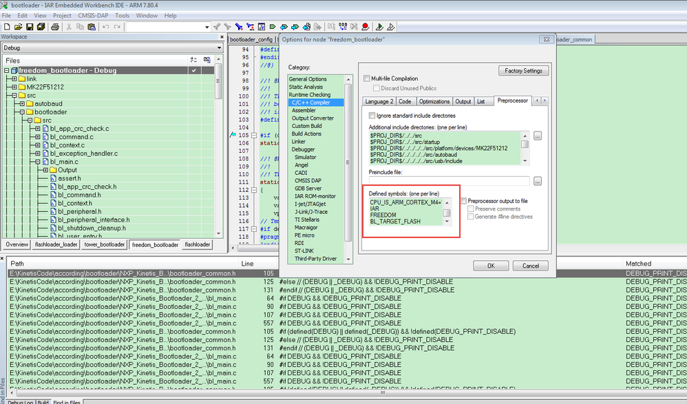

I am working on Kinetis bootloader and want to bring out debug statements on the console.
After browing through the code I found below statement everywhere.
#if DEBUG && !DEBUG_PRINT_DISABLE
#endif
I have DEBUG defined.  Which is the right place to define DEBUG_PRINT_DISABLE as 0?

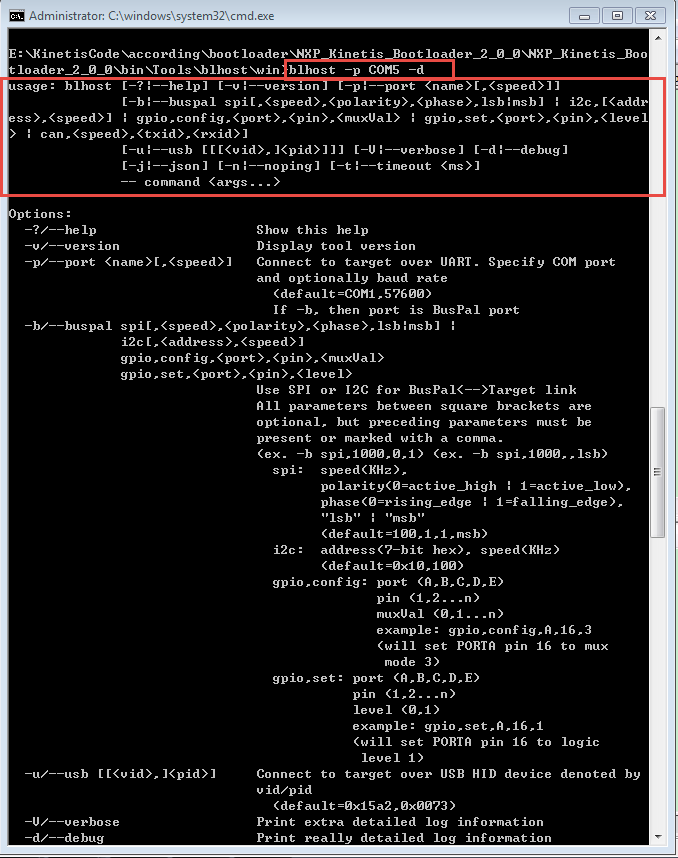

Another question:
If I run command "blhost -d", I was expecting print detailed log information.  But I could do it.
Please  give examples of using blhost -d/debug usage.

Hi Srinivasa Rao Wunnimani,
     1. define DEBUG_PRINT_DISABLE as 0
Normally, if you want to define the according symbols, you can defined it in the project options, take IAR project as an example:
But, if you want to define DEBUG_PRINT_DISABLE as 0, just don't define it, leave it in default is OK.

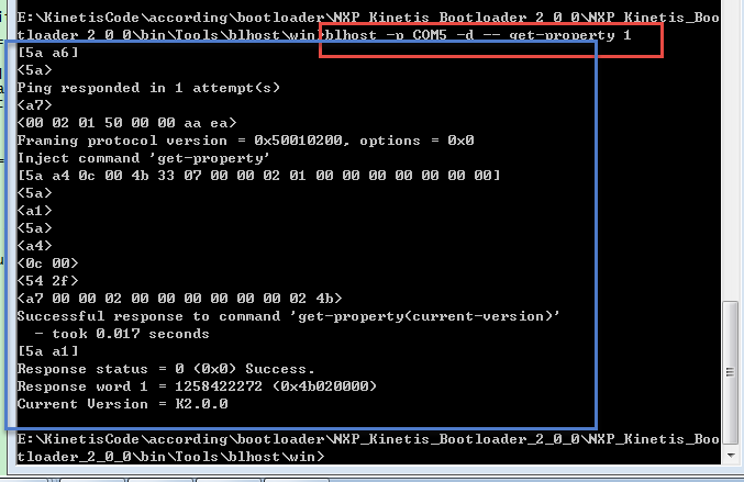

2. give examples of using blhost -d/debug usage.
About the debug usage, you can find it from the blhost printf information.
The following is the command usage on my side:
Take get property as an example:
Wish it helps you!
If you still have question, please let me know!
