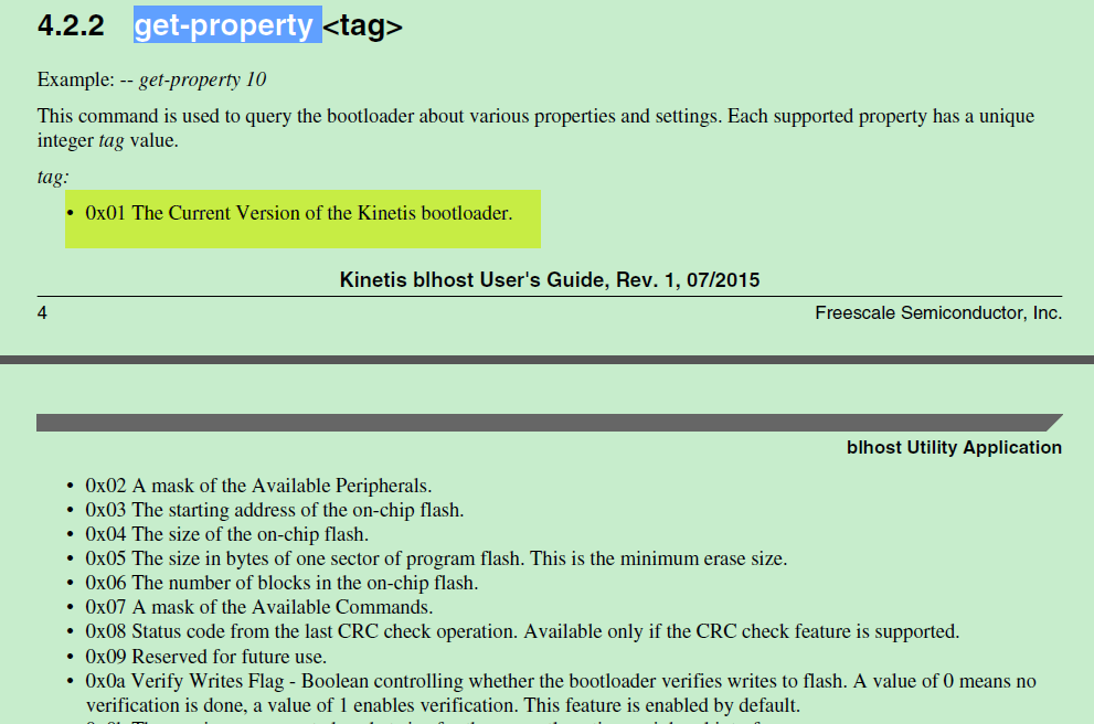

  Normally, customer can read the bootloader version with blhost get-property command:

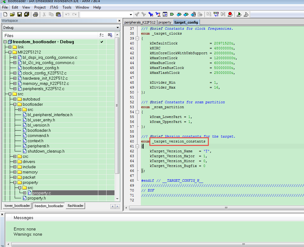

but if you want to read the bootloader version in the app directly, you can define the kboot version in the specific flash address.
you can find the version in the target_config
If you want to read the bootloader reversion, please define the _target_version_constants in the specific flash address, then you can read that flash address to get the reversion directly in your app code.
