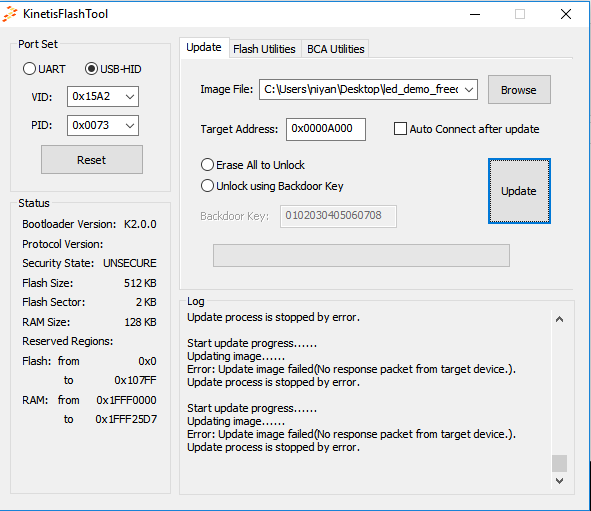

I'm trying to use the Kinetis Flash Tool to make my FRDM-K22 board run the bootloader. Everytime i try to connect to to my device via the Kinetis Tool I get the following(see picture attached) error. What am I doing wrong? Any help would be greatly appreciated!

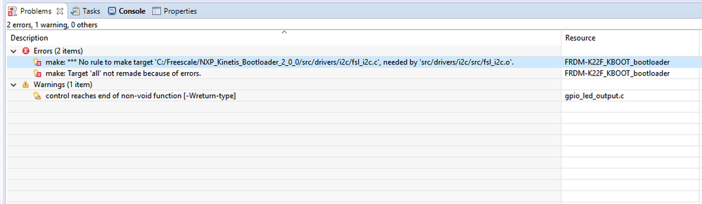

The following is the error I get when I try to build your code in KDS 3.2.0
Please advice.
Edit:
I was able to compile your code after pasting it in the working directory of KDS. Now I face a new problem.

I have fixed the build error on GitHub ( mcuoneclipse/Examples/KDS/FRDM-K22F/FRDM-K22F_KBOOT_led_demo_freedom_a000 at master · ErichStyger/mc... ), as the project still had a link to the KBOOT installation folder (thanks for reporting!).

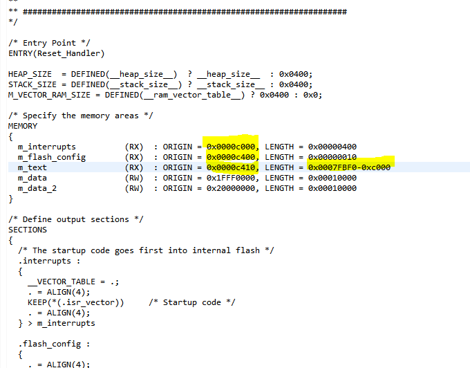

As I understand it right, the bubble demo application should also be memory configured using the linker file starting from address 0xc000 (your bootloader was customized for 0xc000 i.e, the #define BL_APP_VECTOR_TABLE_ADDRESS 0xc000).
So, I made a new linker file that has the new starting address as attached with this message.
I used this linker file and generated a binary for the project and flashed it using the Kinetis Flash Tool after switching to bootloader mode.The update is successful but the desirable outcome is not observed.

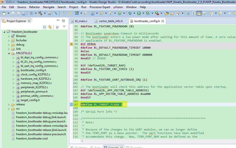

If you are using KDS project.
   Add this below code in bootloader_config.h
 #define BL_TARGET_FLASH 1
2. Application code prepare.
From the freedom_bootloader file bootloader_config.h.
#if !defined(BL_APP_VECTOR_TABLE_ADDRESS)
#define BL_APP_VECTOR_TABLE_ADDRESS 0xa000
#endif
So, you need to relocate the application code to address 0xa000.

I followed your instructions and wasn't able to flash the program successfully. Here is the screenshot;
Please advice.

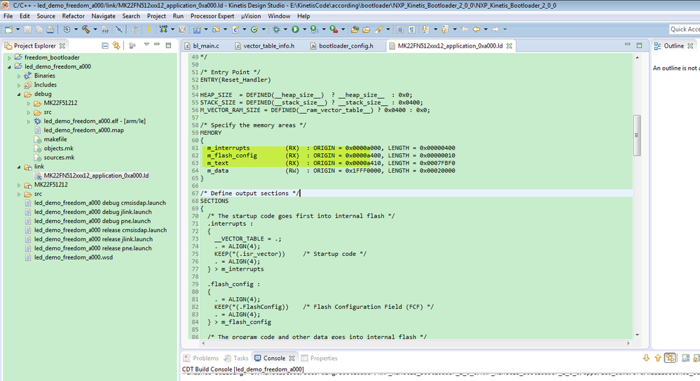

I have created my LED application using processor expert. I changed the memory section addresses to match with the bootloader bl_vector address to make it work. If I am not using the processor expert how can I make the demo application (the bubble demo) change its memory addresses so that I can push that binary using this method.

    Even you don't use the PE, just use the bare application project, you still can refer to the kboot app relocate method, just modify the link file like this:
You can refer to KBOOT app kds project:NXP_Kinetis_Bootloader_2_0_0\apps\led_demo\MK22F51212\kds\led_demo_freedom_a000

Thank you very much for your reply. As per your instructions
>> I defined the macro BL_TARGET_FLASH to 1 inside my bootloader_config.h file.
>> I programmed my K22 with this bootloader application
>> The device appeared as "FSL_Loader" when connected via usb on my PC
>> On the Kinetis Flash Tool, I used the USB-HID option (in the picture) instead of UART
>> I was able to connect with the device
>> However, I wasn't able to flash the bin file
>> The error is shown in the picture attached

  Now, take KDS project as an example: NXP_Kinetis_Bootloader_2_0_0\targets\MK22F51212\kds\freedom_bootloader
  1. take care, using freedom_bootloader, not flash loader loader.
  2. You need to add the following code in bootloader_config.h
3. Use the USB cable to connect J16 interface on the FRDM-K22 board.
4. Open KinetisFlash Tool, choose USB-HID.
  Press on board SW1, then press the connect button in the kinetisFlash Tool.
   You can find I can connect successfully.
5. Update the application code
You can find I can update it successfully.
After download the application code, wait about 6 seconds, you will find the on board led is blinking.
