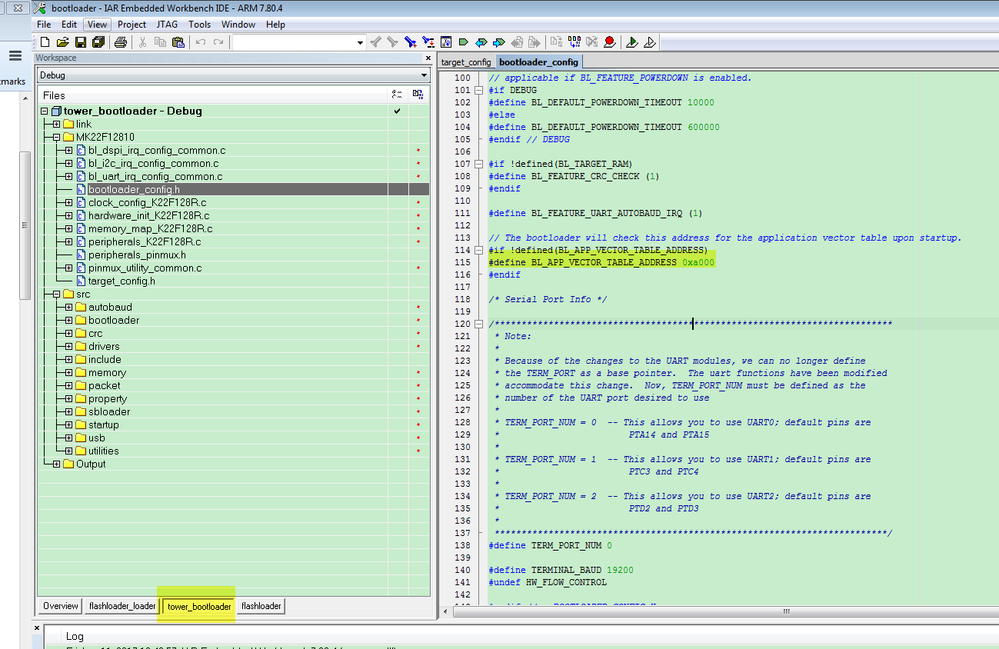

kerryzhou
Hi Arjun Nair,
    flashloader and flashloader_loader is the flash bootloader which can just be used one time, after you download the application code successfully, this bootloader will be disappear.
    If you want the flash bootloader always work, even after you download the application code, you need to use the tower_bootloader or freedom_bootloader.
   Please open KBOOT2.0:NXP_Kinetis_Bootloader_2_0_0\NXP_Kinetis_Bootloader_2_0_0\targets\MK22F12810
 1  Use tower bootloader:
2 Download this bootloader to your chip, then modify your application code, and relocate it to 0XA000, build and generate the app.bin file.
3. You can use kinetisFlashTool to download your application code, the tool can be found in folder:
 NXP_Kinetis_Bootloader_2_0_0\NXP_Kinetis_Bootloader_2_0_0\bin\Tools\KinetisFlashTool\win
After you download the application code successfully, you still can download the new application with the fixed flash bootloader again.
With it helps you!
If you still have question, please let me know!
