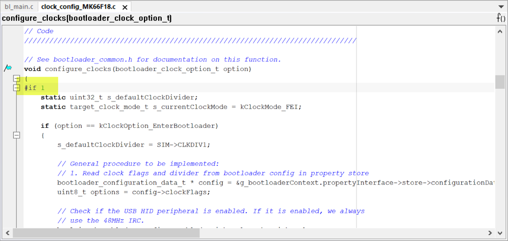

I'm having an issue with the clock configuration while using the freedom bootloader 2.0 on a K66 :
For my application I need to use the default FEI mode, Idrive peripherals like FTM, I2c and DSPI,  and it perfectly worked without bootloader.
The problem is, I have adapted and loaded my application with the bootloader and none of the peripherals seemed to start...
So I tried BOARD_BootClockRUN() in my application with a clock_config.c, and it worked ... only for PBE mode, I tried also for FEI but the application seems to be stuck.
Normally when the bootloader jump to the application it is supposed to set the FEI mode right ? Maybe I missed some initialisations in the bootloader config...
I'm a beginner, thanks for your comprehension,
Alex

Hi alexco
Are you using freedom_bootloader in release mode? If so, please go to the file clock_config_MK66F18.c, you may have the configure_clocks function disable with a #if macro, so please enable it with 1:
This function is used in the clock_config_init and in the shutdown_cleanup process of the bootloader.
Hope this helps

Hi Jorge,
Thanks a lot for your help,
I am effectively in release mode for the freedom_bootloader, unfortunately I have tried to enable this section, and it still doesn't work for FEI.
Btw I have good results with a PEE config (I used ConfigTool  to generate my clock_config) and I think I going to use it if the problem persists.
Alex
