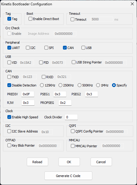

Hi, this is how I was able to make 125 KHz work, it may be specific to our custom board based on KE16F but may be useful to someone else, so sharing it here.
Some initial facts:
  • MCU boot loader version: 1.5.1
  • Source code looked at, boot loader versions 1.2.0 and 2.0.0
  • The handling of BCA parameters for CAN bus timing in boot loader code 1.2.0 and 2.0.0 are identical.
  • Using tool KinetisFlashTool.exe from boot loader source code 2.0.0
The following information allowed me to define proper CAN bus timing parameters:
  1. In tool KinetisFlashTool, check "Disable Detection", "Specify" and "Enable High Speed" to define your own CAN timing configuration.
  2. In calculating the pre-scaler divider, assume 24 MHz (instead of 48 MHz).
  3. Select the timing parameters PRESDIV, RJW, PSEG1, PSEG2, and PROPSEG  that you need, and subtract 1 from them and the resulting values set in KinetisFlashTool (this is explained in the MCU reference manual).
E.g. to configure CAN bus for 125 KHz
For our timing, let's select (in clock cycles after the pre-scaled divider):
Sync segment (always 1) + PSEG1 (4) + PSEG2 (4) + PROPSEG (3) = 12 cycles
Such that 24MHz / 12 = 2 MHz
Then 2 MHz / 125 KHz =16 = PREDIV
Apply the above parameters in KinetisFlashTool.exe (remember the -1): PREDIV=0x0F, PSEG1=0x3, PSEG2=0x3, RJW=0x3 and PROPSEG=0x2 and generate C code.
The resulting code will include this line that needs to change:
.canConfig1 = 0xAF, //!< Use user-defined canConfig1
Now manually change to the following, before using it to store that in BCA area:
.canConfig1 = 0xA8, //!< Use user-defined canConfig1
This is the portion of CAN boot loader code (file `flexcan_peripheral_interface.c`) to look at to understand why 0xF doesn't work and why changing it to 0x8 make the parameters you set to actually be used to configure CAN peripheral:

 This is how the tool KinetisFlashTool.exe looked like after selecting the parameters I wanted:
#define FLEXCAN_SPEED_MASK 0x0F
#define FLEXCAN_SPEED_SPEC_MASK 0x08
    // check baud rate config
    if ((canConfig1 & FLEXCAN_SPEED_MASK) == 0x0f)
        // not specified, go with auto detection feature enabled
        s_flexcanInfo.baudrateDetect = true;
        // select default baud rate 1M
        s_flexcanInfo.baudrate = FLEXCAN_MAX_SPEED - 1;
    else
        // baud rate config specified
        s_flexcanInfo.baudrateDetect = false;
        if (canConfig1 & FLEXCAN_SPEED_SPEC_MASK)
            // specified baud rate setting directly
            s_flexcanInfo.baudrate = FLEXCAN_MAX_SPEED;
            // get config data from BCA area
            canConfig2 = g_bootloaderContext.propertyInterface->store->configurationData.canConfig2;
            // prepare specified config data
            bit_rate_table1.pre_divider = (canConfig2 & FLEXCAN_PRESCALER_MASK) >> FLEXCAN_PRESCALER_SHIFT;
            bit_rate_table1.pseg1 = (canConfig2 & FLEXCAN_PSEG1_MASK) >> FLEXCAN_PSEG1_SHIFT;
            bit_rate_table1.pseg2 = (canConfig2 & FLEXCAN_PSEG2_MASK) >> FLEXCAN_PSEG2_SHIFT;
            bit_rate_table1.rjw = canConfig2 & FLEXCAN_RJW_MASK;
            bit_rate_table1.propseg = (canConfig1 & FLEXCAN_PROPSEG_MASK) >> FLEXCAN_PROPSEG_SHIFT;
        else
            // specified speed index, baud rate settings from bootloader
            s_flexcanInfo.baudrate = canConfig1 & FLEXCAN_SPEED_INDEX_MASK;
            if (s_flexcanInfo.baudrate >= FLEXCAN_MAX_SPEED)
