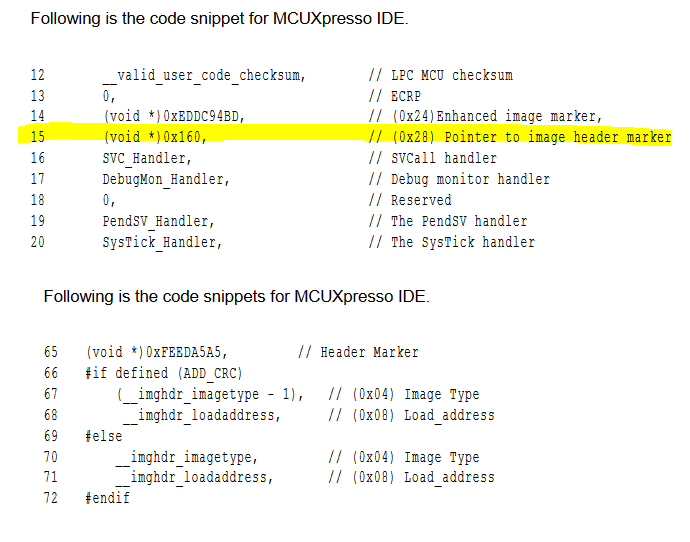

When writing to the internal flash using the I2C ISP protocol I can write, read, erase PAGES, BLOCKS and SECTORS with no issues as long as I stay away from the 512 bytes starting at 0x0.
When I BLOCK write #0 I do not get an error ack which is an error in itself.
However when I PAGE write #0 I get this error: ERR_USER_CODE_CHECKSUM which is probably also not the correct error message since I have the correct checksum writing everywhere else.
I then used a SEGGER JFlash tool to burn the chip via SWD and read out the flash via I2C.
I then discovered that the word at 0x28 was not identical to the file. The Segger tool had modified this when burning. If I do the same thing and modify my image I'm able to burn it via I2C as well.
I'm burning 0xdffd604a at offset 0x28.
So there is obviously some sort of qualification being performed when writing the the start of the flash.
However I'm unable to find proper documentation on the requirements and what this magic number is.
From looking at image documentation this corresponds to the vector 11 in the image and should contain a valid pointer to an enhanced boot block structure, is this the clue?

The error for the checksum is interesting, typically a debugger  calculates the checksum while programming,  the difference on the offset value 0x28 may explain the error in the checksum, I'll check this further.
On the other hand regarding the value for the 0x28 (vector 11 on page 0)  that points to the the boot structure. I asume that you are developing a enhanced image (single or dual ), is that correct? For legacy images the offset 0x28 of flash is equal to zero, the same case with 0x24.

As you know the 0x28 offset is required for enhanced images,  typically points to a boot block structure as shown in the following  illlustration.
( This is taken from the  AN12122LPC540xx Image Header Structure )
Since the 0x28 is pointing at 0xdffd604a  , that  is outside of the flash memory region.At the moment  It is hard to explain from were comes this value. Maybe we are overlooking something.
If you are able to  provide further details    you can post it for other users  reference.
