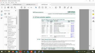

Our company is design the programer, Local in Guangzhou China(www.up48.com).
Now, We are try to add the NXP LPC13xx to our device. Via the swd to programe the mcu flash.
But we can't find the doc about the FMC Register description.

xiangjun_rong
Pls refer to section 21.16 Flash controller registers, especially FLASHCFG register for flash delay configuration.
Hope it can help you

Luoyin
Hello, thank !
Yes, I note that before, But it no detail description.
For example, how to set the REG to erase the chip, program the flash and unlock chip, etc.
I thank, It should be have a doc to describe.

xiangjun_rong
For Flash programming operation, pls refer to section in UM10524.pdf:
21.14 IAP commands
There is code in ROM, which provides flash eraing/programming api function, you can call them.
