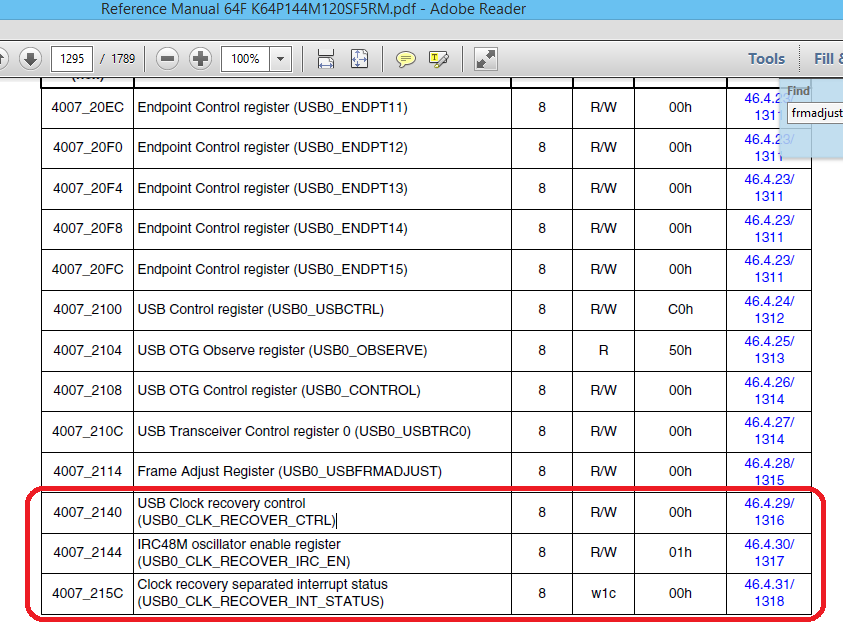

2) I tried using MK22F51212 device as a reference (copied these files into a newly created directory MK22FA12), and then copied over the header files from "C:\Freescale\KSDK_1.3.0\platform\devices\MK22FA12" to complete it.
But it seems like there's a fundamental difference in the clocking scheme, where MK22F-512 calls "usb_clock_init" and sets the following:
    // need to set the clock_recover_en and irc_en register
    USB0->CLK_RECOVER_CTRL |= USB_CLK_RECOVER_CTRL_CLOCK_RECOVER_EN_MASK;
    USB0->CLK_RECOVER_IRC_EN |= USB_CLK_RECOVER_IRC_EN_IRC_EN_MASK;
Well, MK22FN1M0XXX12 doesn't have those registers.
Specifically in MK22FN1M0XXX12 Reference Manual and header MK22FA12.h, it stops at USBFRMADJUST.
  __I  uint8_t OBSERVE;                            /**< USB OTG Observe register, offset: 0x104 */
       uint8_t RESERVED_23[3];
  __IO uint8_t CONTROL;                            /**< USB OTG Control register, offset: 0x108 */
       uint8_t RESERVED_24[3];
  __IO uint8_t USBTRC0;                            /**< USB Transceiver Control register 0, offset: 0x10C */
       uint8_t RESERVED_25[7];
  __IO uint8_t USBFRMADJUST;                       /**< Frame Adjust Register, offset: 0x114 */
#if MY_HACK
       uint8_t RESERVED_26[43];
  __IO uint8_t CLK_RECOVER_CTRL;                   /**< USB Clock recovery control, offset: 0x140 */
       uint8_t RESERVED_27[3];
  __IO uint8_t CLK_RECOVER_IRC_EN;                 /**< IRC48M oscillator enable register, offset: 0x144 */
       uint8_t RESERVED_28[23];
  __IO uint8_t CLK_RECOVER_INT_STATUS;             /**< Clock recovery separated interrupt status, offset: 0x15C */
#endif
} USB_Type, *USB_MemMapPtr;
When avoiding to set the non-existing USB registers, I could continue to load the project.  But unfortunately the KinetisFlashTool doesn't recognize the device, neither as COM PORT (doesn't come up as something that Windows recognize), nor as HID device (0x15A2,0x0073).

Hi Cecylia,
According to statement, I've ported the K64_bootlaode to the K21_120, as the K21_120 doesn't have the following registers.
USB0_CLK_DECOVER_CTRL
USB0_CLK_DECOVER_IRC_EN
USB0_CLK_DECOVER_INT_STATUS
And I've adapted the usb_clock_init() which is illustrated below. When the bootloader demo runs on the TWR-K21F120M board, KinetisFlashTool can recognize the device through the COM port or the HID interface.

This is what I mentioned in my previous comment, that 64F and 22F1M seem to
differ in this register, i.e., 22F1M doesn't have these fields.
I just disabled this for now.

cwati
Hi Ping,
Sorry I uploaded the wrong directory.  Yes, I changed the flash size for 1M0 board when porting from 512.
Anyways, I will try to port now from K64_120 now and will write down the exact steps.  In the mean time, can you please look up/comment on how to port the "usb_clock_init" from either hardware_init_MK64F12.c or hardware_init_K22F512.c?  Both of these processors have this *CLK_RECOVER_CTRL* registers on their USB Memory Map.
Whereas the K22F_1M0 doesn't have anything after USBFRMADJUST.  Needless to say, I got a Hard Fault when trying to set this.
Maybe there's another file I can port for this part?
