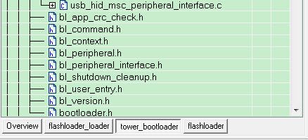

In the ~\NXP_Kinetis_Bootloader_2_0_0\NXP_Kinetis_Bootloader_2_0_0\targets\MK65F18, the KBOOT v2.0 has provided two kinds of the bootloader demo, Flashloader and Tower_bootloader, which one do you choose?
Ping
9,637 Views
ken_sallings1
I am using tower_bootloader.
