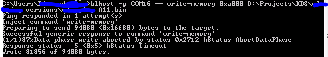

I'm flashing various boards in production phase. All are custom boards with K64 on them. I'm using Kboot and blhost to load the application.
In one of the board I'm receiving the kstatus abort data phase error.
This happens all the time in this specific board.

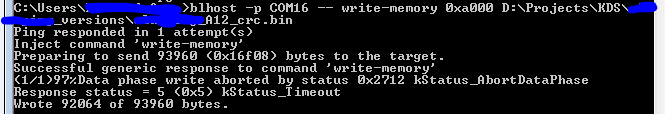

When the blhost reaches 97% it stops immediately. I've tried flashing a different application version and there it stops at 87% (see picture). Flashing at different speed didn't change anything.
different file:
Both files are perfectly fine and they are different versions of the application, running fine at other boards.
Any idea?

Hi Roy,
    From your description, I am afraid it's your board hardware stable problem.
    The Kboot we have test it on our official board, it's no problem. I think you can check your problem board's hardware, whether the GND is stable enough, you also need to check your USB-TTL device, whether the wire is too long or any other EMI in your test situation.
    If your TTL-USB works for most of the board, just one specific board have the problem, I think it's your customer's board hardware problem. Please check your hardware.
Wish it helps you!
