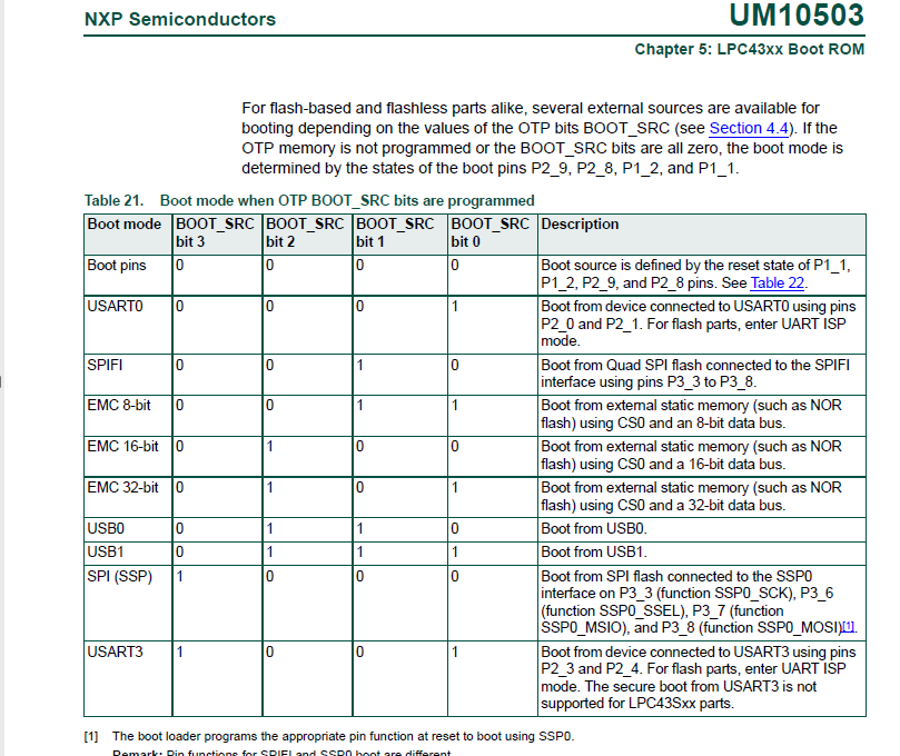

I have an LPCXpresso43S67 Development Board| and am looking for a good bootloader for it.
990 Views
kerryzhou
Hi Fred Basset,
    The LPC43S67 already have the ROM bootloader, you can find it from the user manual:
Please check these bootloader, you can use our hardware ROM bootloader directly.
