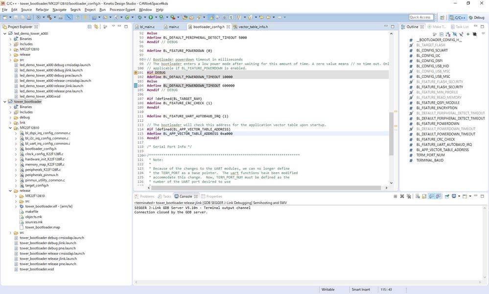

Hi Daniel,
I'm using Tower bootloader as attached bitmap.

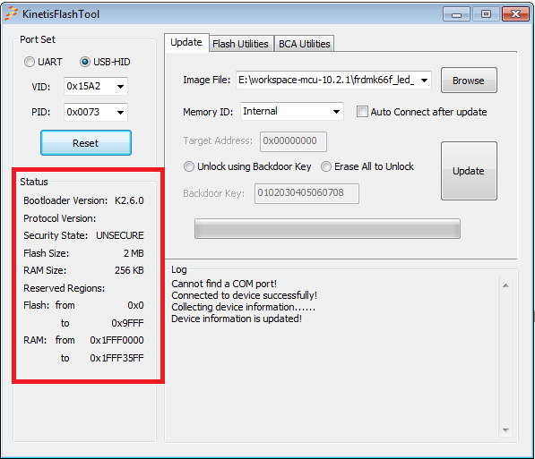

You are running Tower_bootloader,  If your FSL_Loader gone and appears again, probably your LED demo not update successfully. Did you see the led blinking?
Before you begin the update process, please make sure KinetisFlashTool connected correctly, see below picture.
Then you can update your led demo.

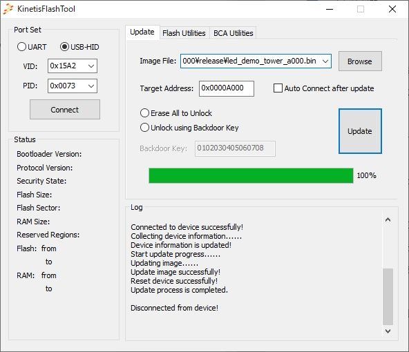

shuichiy
Hi Daniel,
Thank you for your response.
I carefully read the thread then tried again, but the situation has not changed.
I tried to update the firmware using both .bin and Intel hex, updating successfully finished but "FSL Folder" drive comes back promptly.
Here is contents of INFO.TXT in the drive and a bitmap of Flash tool.
If you can add any comments, please let me know.
