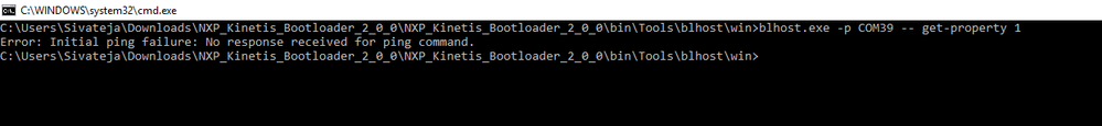

sivatejareddyva
Hey Kerry,
I have flashed release freedom_bootloader at 0x00 and i am still seeing it as USB Serial. Please check the image below
also, i tried to use blhost.exe, it went like this....
But, i have flashed Led_demo a000, and was able to see a flashing red LED.
Am i missing something ??

kerryzhou
Hi Siva,
    Before you connect the MCU with blhost get property command, do you press the reset button on the board at first? This is very important to ping the MCU, please try the reset, then do it again.
    Besides You can use the KinetisFlashTool to download the .app, that is the GUI, it's more easy to use.
