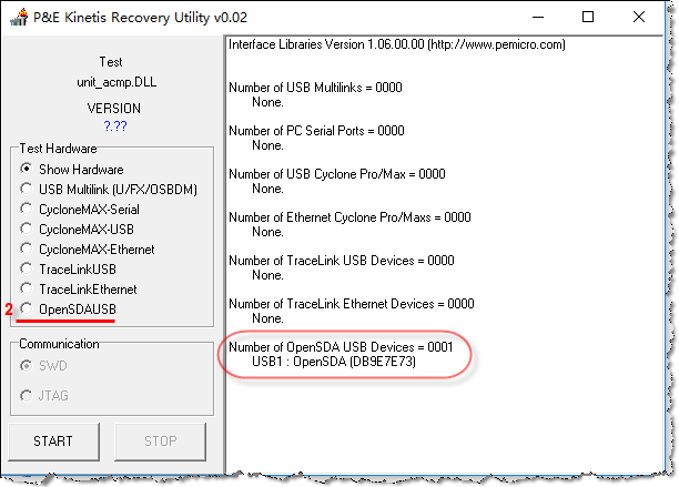

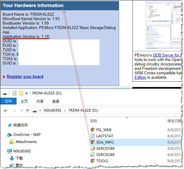

The Application Version of my FRDM-KL02Z is: 1.18, you can use the attached MSD-DEBUG-FRDM-KL02Z_Pemicro_v118.SDA.
It works on at my PC with Win10, you can try it on WinXP or Win7 too.

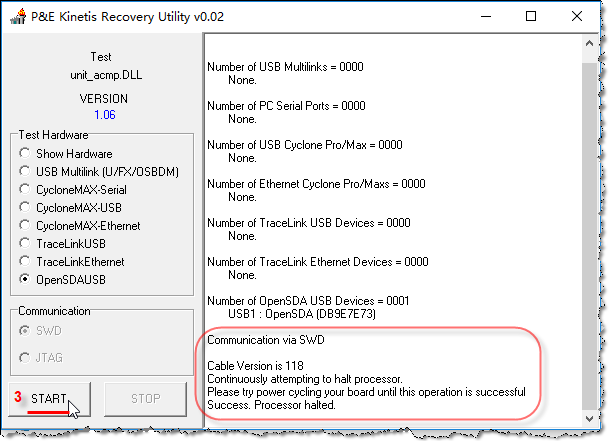

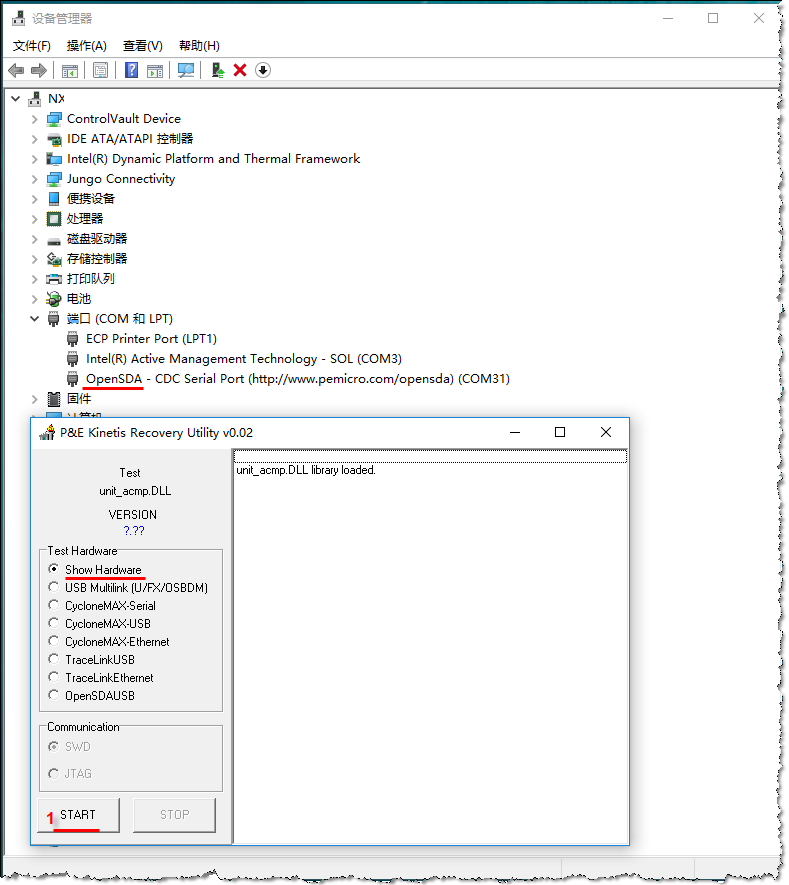

During and following a reset, the SWD pins have their associated input pins configured as:
• SWD_CLK in pulldown (PD)
• SWD_DIO in pullup (PU)
You can try to press SW1 on FRDM-KL02Z when using Kinetis_Recovery_Utility.
If you did not disable NMI_b function through FTFA_FOPT[NMI_DIS], you can also try to connect NMI_b(PTB5 Pin4 J8) to GND.
