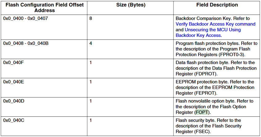

1.- Enter at Start-up Process & Timeout exit:
   1.1.- FOPT [7] is set to 1
 "FOPT [7] is set to 1. This forces the ROM to run out of reset:"
// Flash Configuration block : 16-byte flash configuration field that stores
// default protection settings (loaded on reset) and security information that
// allows the MCU to restrict access to the Flash Memory module.
// Placed at address 0x400 by the linker script.
__attribute__ ((used,section(".FlashConfig"))) const struct {
 unsigned int word1;
 unsigned int word2;
 unsigned int word3;
 unsigned int word4;
} Flash_Config = {0xFFFFFFFF, 0xFFFFFFFF, 0xFFFFFFFF, 0xFFFFFFFE};‍‍‍‍‍‍‍‍‍‍‍‍‍
//__________________________________________________________^^__
//Byte of FOPT -> FF ->FOPT[BOOTSRC_SEL] set to 1 & FOPT[BOOTPIN_OPT] set to 1‍‍‍‍‍‍‍‍‍‍‍‍‍‍‍‍‍‍‍‍‍‍‍‍‍‍‍‍‍‍‍‍‍‍‍‍‍‍‍‍‍‍‍
These code lines can be found in the startup_mke18f16.c file.
The information about FOPT register is in these tables (FOPT address and FOPT register) in the KE1xFP100M168SF0RM document:

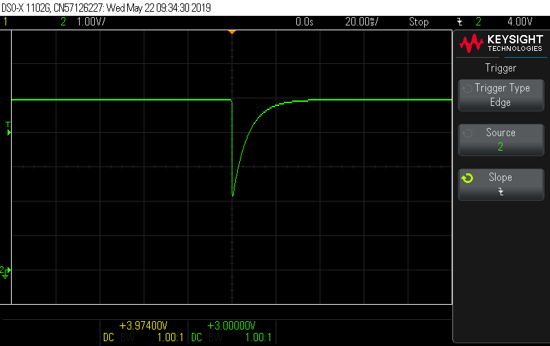

When I use this configuration, the MCU enters the Bootloader and I can establish communication via CANbus. But if I don't communicate and I let the five seconds pass (default config), it times-out and resets, but it enters the Bootloader over and over instead of jumping to flash user application. We can see the "timeout and reset every 5 seconds" in these oscilloscope captures:

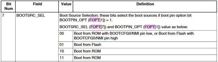

   1.2.- BOOTCFG() pin is asserted
"The pin must be configured as BOOTCFG0 by setting the BOOTPIN_OPT bit of FOPT to 0."
 unsigned int word1;
 unsigned int word2;
 unsigned int word3;
 unsigned int word4;
} Flash_Config = {0xFFFFFFFF, 0xFFFFFFFF, 0xFFFFFFFF, 0xFFFF7DFE};‍‍‍‍‍‍
//Byte of FOPT -> 7D ->FOPT[BOOTSRC_SEL] set to 0 & FOPT[BOOTPIN_OPT] set to 0‍‍‍‍‍‍‍‍‍‍‍‍‍‍‍‍‍‍‍‍‍‍‍‍‍‍‍‍‍‍‍‍
The information about BOOTCFG0 configuration is in this table in the KE1xFP100M168SF0RM document:
When I use this configuration, I force the BOOTCFG0 pin to GND then I power-on MCU. The MCU enters the Bootloader successfully but timeout is disabled, after five seconds pass it doesn't timeout. I don't know why this is happening, BCA has the default configuration. But nevertheless when I do a reset through the reset_b pin, it enters the Bootloader again but now, after five seconds, it times-out, resets and jumps into the flash user application (desired behaviour).

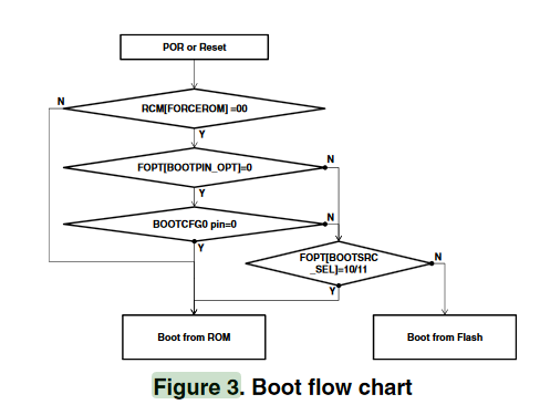

We keep in mind the next two flow chars and I think the problem is the two conditional blocks before "Disable Timeout" detection (in Figure 23-2- Kinetis bootloader Start-up Flowchart). We don't know what "Is user application valid?" block is checking.
I have tried these configurations segmenting the flash memory in order to add a manually configured BCA. After setting up the Linker file, the result has been the same. Both projects are attached at the end of the post (Bootloader_KE18f_Projects.zip).

When we enter into the bootloader with FOTP[BOOTSRC_SEL]== 11, it doesn't exit with the timeout detection. Could the issue be related with "Is user valid application?" block (1)?
If we enter the bootloader with the API (2.6 Bootloader entry point) and then do a reset pulling the Reset_b pin to GND, only then, it enters the bootloader and then exits with the timeout successfully and returns to the user application. Maybe this means that the user application is valid?
