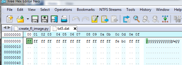

But the problem is that when I try to read this configuration using the blhost utility I find the Flash Security in UNSECURED state, and the command
blhost.exe -p COM3 read-memory 0x400 16 ./FCA.dat yields the following  test.png
Can any one tell why the SEC setting are beings always set as 'E' 1110 where 10 is unsecure?

Hi Saurabh,
     If you just want to use the blhost to check the 0X40C data, and you find the 0X40C still 0XFE and not the 0XFF which you want to download.
    I don't know how you download the secured code to the chip? Some IDE or the debugger need to do the configuration, otherwise the secure area won't be updated.
   I highly suggest you generate the .hex file, then check the 0X40C at first, make sure the app.hex 0X40C is really 0XFF, then you can use the blhost download that app, then check it again.

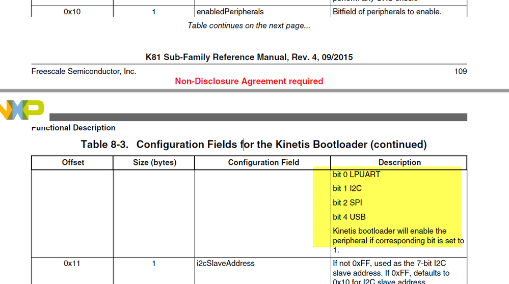

     You are misunderstanding the FSEC secure function.
    Please check the K81 reference manual:
FSEC is just limit the debug access through the SWD/JTAG interface, it won't limit the ROM bootloader function.
 If you also don't want the ROM bootloader function work, you can can configure the BCA area, just disable the according ROM bootloader interface:
Wish it helps you!
