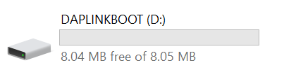

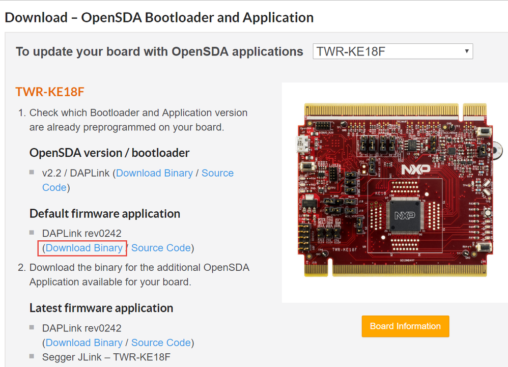

Hui_Ma
When you press RESET(SW1) button and connect USB cable to PC, you will find the TWR-KE18F enumerated as a USB disc:

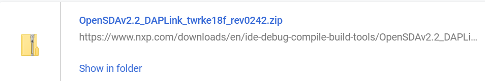

Then you can visit here to download DAPLink rev0242 firmware:
You can copy and paste [k20dx_twrke18f_if_crc.bin] to DAPLINKBOOT(D:) disk.
After above steps done, you can re-plug USB cable to PC without press RESET button, you can find DAPLINK(D:):
From Windows Device Manager panel, you could find there shows DAPLINK:
