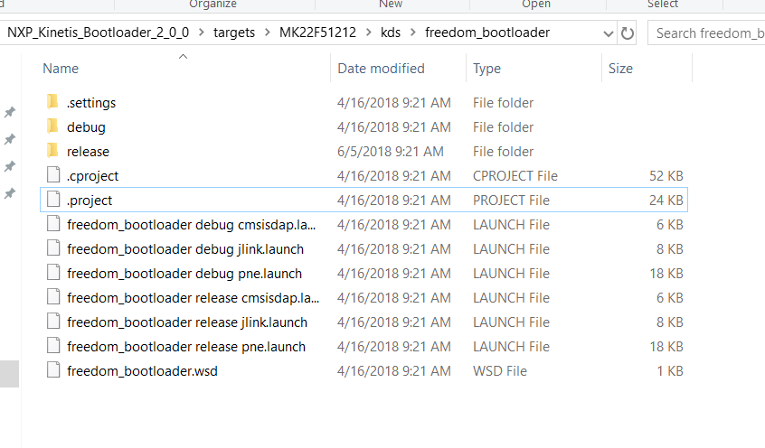

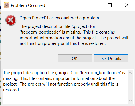

I am having issues opening freedom_bootloader using the KDS v3.2. I am trying to follow this post Trouble with FRDM-K22 and Kinetis Flash Tool | NXP Community any suggestions? I get this error. It is also in the directory.
But I am unable to open up that file to edit it. Also I need to flash that freedom_bootloader file onto my K22 FRDM board correct? Should I use my JLINK segger or the KinetisFlashTool to do this? After that is complete, I just use the KinetisFlashTool to point to the binary file I want to use and update then?

    1. KDS open k22 freedom_bootloader problem.
       Please delete your bootloader2.0, then unzip a new one at first.
       Then open the KDS IDE, note, choose the workspace path in NXP_Kinetis_Bootloader_2_0_0, don't select the workspace path in the project area.
      Now, import the project under: NXP_Kinetis_Bootloader_2_0_0\targets\MK22F51212\kds\freedom_bootloader
     I have tested it, it works OK on our side.
2. Download
     You can use the KDS download the bootloader code to your FRDM-K22 board at first with JLINK.
    KinetisFlashTool is used to download the app code after you already download the bootloader code to your K22.
Please try it again.
