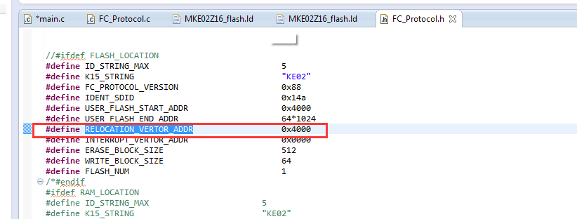

Hi Huy,
Please pay attention that, the flash size of your chip MKE02Z16VLC4 is 16K 0x0000 - 0x3FFF,
so you can't put the new vector table(APP vector ) into 0x4000 .
Also please refer to AN4767->2.4 User code to configure your APP.
If still have problem, I recommend you open the bootloader GUI win_hc08sprg(it under AN2295 ) project to debug ,
the information from GUI view can find in the GUI project source.
Hope it helps

huyrua291996
Hi Alice,
I've changed in FC_Protocol.h and I also change the linker file in my application code
Can you review for me both project in CW
I also use AN2295 GUI and it 's seem wrong
It's wrong in Memory Block. In the Identification it's Block 1 and when erase and write it's Block 0
What should I do
