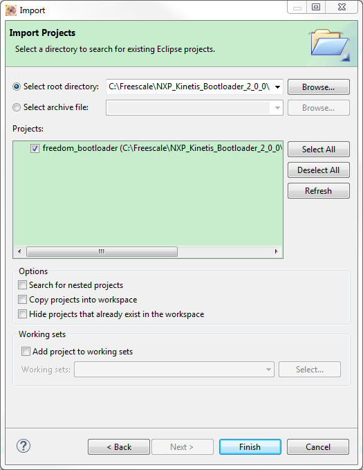

The IDE software could select IAR, KDS or Keil.
The bootloader project for KDS IDE could be found with below path:
..\NXP_Kinetis_Bootloader_2_0_0\targets\MKL25Z4\kds
For you are using FRDM-KL25Z, you need to select the [freedom_bootloader] demo, which located at :
..\NXP_Kinetis_Bootloader_2_0_0\targets\MKL25Z4\kds\freedom_bootloader
Then you need use KDS software menu [File]->[Import]->[Existing Project into Workspace], then to select the root directory and following the wizard to import the project.
Wish it helps.

I've downloaded NXP_Kinetis_Bootloader_2_0_0/, and I have a simple question: How do I compile the flash-based bootloader for the MKL25Z4 target?
Is there a project file to import into KDS?  Is there a Makefile?  My goal is simply to compile an image that I can load into a FRDM-KL25Z board to verify that I've made a working flash-based bootloader, but I don't see how to do that.
Thanks in advance.
Wish it helps.
Ma Hui

robertpoor
Senior Contributor I
Ma Hui: Yes - that was the info I needed to get going.  I have other questions, but I'll start a separate thread for them -- in the meantime, I'm marking this as the correct answer.  Many thanks.
