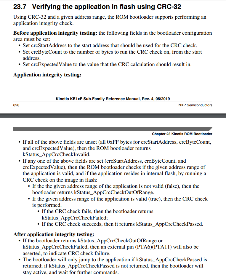

We followed the steps of chapter 23.7, Kinetis KE1xF Sub-Family Reference Manual:
But were should we receive these kStatus? When? After last data frame? Automatically? We don't have a clue.

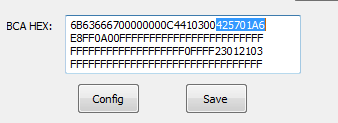

In BCA we've configured the next CRC values:
.crcStartAddress = 0x000003d0, //!< Disable CRC check
 .crcByteCount = 0x000337fc, //!< Disable CRC check
 .crcExpectedValue = 0xF913CCAD, //!< Disable CRC check‍‍‍

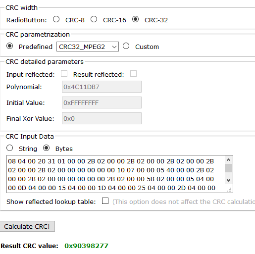

For the image CRC32 calculation, You can use this online tool http://www.sunshine2k.de/coding/javascript/crc/crc_js.html with below configuration
In Kinetis device, we need to bypass byte address 0x3cc ~ 0x3cf (bypass length is 4 byte) when calculating image CRC.

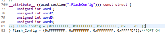

For his you will first need to set the MCU to boot from ROM, with this after the reset the BCA configurations should be executed.
For this you need to set the FOPT, BOOTSRC_SEL first.
If you're using MCUXpresso, you can set this field writing in the startup code, in the flash config:
Let me know if this helps you.

We already had this configuration to update via Bootloader:
FOPT-->
BCA-->
Everything goes alright until the host finishes writing the data to the target successfully and then we try to do a reset (5A A4 02 00 66 64 0B 00); after the reset the MCU is still in bootloader and does not exit by timeout.
But were should we receive the CRC kStatus? When? After the last data frame? We still don't have a clue.

Alexis_A
Hello Jan,
As you mention, I also can't identify where this response is send, I will investigate further about this issue, but meanwhile if you want to identify if the CRC was done correctly the pin PTA 11 is asserted when the CRC check fail after the reset.

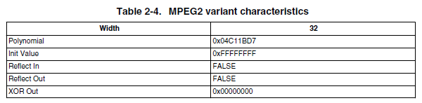

In the chapter that you mentioned I see the CRC 16 algorithm (XMODEM variant) used for calculate the CRC for bootloader frames , but for CRC 32 algorithm (used by the Bootloader to check API integrity, 0x3CC) what is the variant that its uses?
We noticed that in the 1.2.0 version of MCU Bootloader Reference Manual doesn't say anything about CRC 32 algorithm calculate but in 2.0.0 or 2.5.0 says CRC 32 uses MPEG2 algorithm variant.
We have compared our CRC 32, standard and MPEG2, calculated value with the KFT value and doesn't match.
Our CRC 32 calculate:
KFT CRC 32 Calculate:
