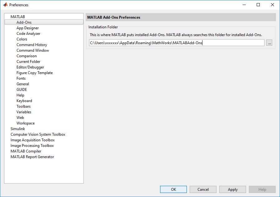

Hello, I am currently trying to run the NXP Vision Toolbox examples on my S32V234 board.
The cnn_squeezenet_image.m simulation works perfectly on my computer, but I always get an error when I try to compile it for the S32C234 dev-board (run_cnn_squeezenet.m). The only change I made is the IP-address. The Vision SDK has the HF2 applied, arm compute library version 18.03, APU compiler v1.0 b530.
Please see the output from the command window (also attached as files below for better readability):

It seems like the compilation target is ‘Matlab’, how do I change it to the S32V234?
Thank you!

Hi [email protected]‌,
You need to change the Matlab Add-ons installation folder because our VSDK doesn't support spaces in paths.
Open the Matlab Preferences windows and select Matlab -> Add-Ons page. There change the path to one without spaces in it. e.g.: C:\Users\xxxxxxx\AppData\Roaming\MathWorks\MATLABAdd-Ons. Notice the missing space character between 'MATLAB' and 'Add-Ons'.
You can rename the initial folder such that it doesn't contain spaces and update the path in the Matlab Preferences after. You must close the Matlab before renaming the add-ons installation folder.
After you change the add-ons installation folder, you need to reinstall the NXPVT Vision Toolbox.
Another thing I want to point out is that we didn't test our toolbox with VSDK 1.3.0 HF1 or HF2. We recommend you to use VSDK 1.3.0 release without hot fixes, HF1 and HF2.
