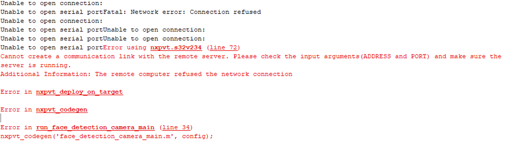

Hi guys,
I have encountered this problem in compilation of the NXP Vision Toolbox, the visionsdk version is rtm 1.3.0. Anyone got idea? As I can notice that the path of the nxpvt_apexcv_peopledetector.cpp is "C:/Users/DavidChong/Documents/MATLAB/Add-Ons/Toolboxes/NXP_Vision_Toolbox_for_S32V234/code//internals/src", why is there extra "/" between code and internals? From my matlab R2018a, I do not see that extra "/" in the set path in matlab R2018a.

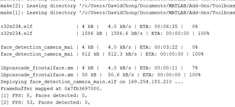

Hi Paul,
Thanks for the advice, when I download the VSDK RTM 1.2.0 HF2 patch from the link, this is what i get in Figure 2 when i click in the link. After that, I try to save it manually as hf2_vision_sdk_rtm_1.2.0.patch and run the msys32.exe with this command "patch -p1 -i hf2_vision_sdk_rtm_1.2.0.patch", I get Figure 1. Any advice? Thanks
(Figure 1)
(Figure 2)
4,566 Views
david_chong
Hi Paul,
Finally successfully done, thanks very much

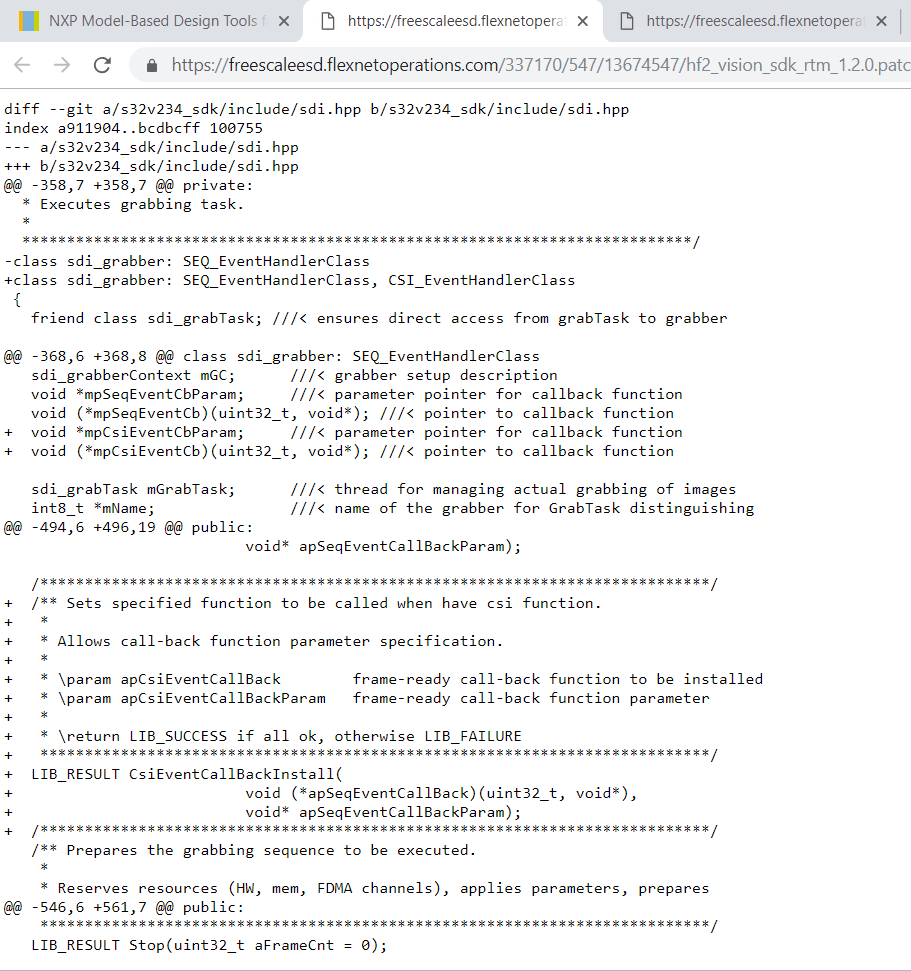

paulvlase
Hi [email protected]‌,
That extra "/" doesn't affect the build of the application. You get that build error because the latest release of NXP Vision Toolbox, 2018.R1, works only with VSDK RTM 1.2.0 HF1 with HF2 patch applied.
To download VSDK RTM 1.2.0 HF1 click here .
To download VSDK RTM 1.2.0 HF2 patch click here . Save the hf2_vision_sdk_rtm_1.2.0.patch to C:\NXPs3\VisionSDK_S32V2_RTM_1_2_0\ (or wherever you have HF1 installed).
After you download both files, and install VSDK RTM 1.2.0 HF1, you need to apply the HF2 patch.
To do that follow this steps:
  1. Run msys32.exe from C:\NXPs3\VisionSDK_S32V2_RTM_1_2_0\msy2 folder. This opens a Linux shell.
  2. Run in the msys32 shell cd /c/NXP/VisionSDK_S32V2_RTM_1_2_0_HF1 to change the current directory to /c/NXP/VisionSDK_S32V2_RTM_1_2_0_HF1 (or wherever you have HF1 installed).
  3. Run in msys32 shell pacman -S patch to install the patch program.
  4.  Run in msys32 shell patch -p1 -i hf2_vision_sdk_rtm_1.2.0.patch to apply the HF2 patch.

hasanfirdaus8
Hi Paul Vlase,
Apparently I am having similar problem as David Chong. I have already followed your instructions to install the VSDK RTM 1.2.0 HF1 with HF2 patch, however, I got a new error which reads as the following:
I have already followed the instruction on the IP address as stated in the quickstart tutorial. Could you assist me on this?
4,566 Views

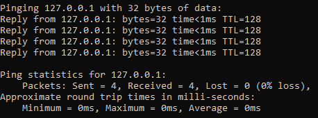

paulvlase
Is your S32V234 board connect to the network? Are you able to ping the board from the windows cmd (ping BOARD_IP) ?
4,566 Views
hasanfirdaus8
Hi paulvlase,
Yes, I am able to ping the board from the command prompt, as can be referred to this figure below. The thing is, the codegen seems successfully created, the only problem is the porting of the code to the board. For your info, I have also unabled windows firewall, in case there is issue with the firewall. Is there any chance the problem lies with the firewall of my institution's internet?
4,566 Views
