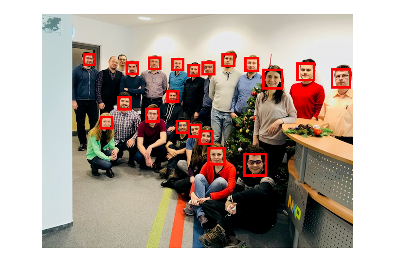

Apply the face detection algorithm on the grayscale image.
[bbox, l] = fdetector.GetFaces(inImgUMat);
Add the result on the original image.
outImgUMat = nxpvt.cv.rectangle(inImgUMat, bbox, [255, 0 ,0], 5);
nxpvt.imshow(outImgUMat);
