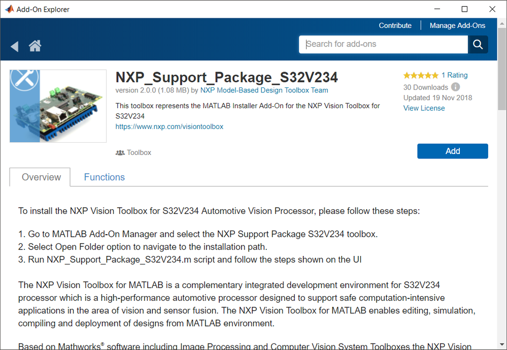

1. Open MATLAB 2018a and select Get Add-Ons
2. Once the Add-On Explorer window opens, search for “nxp vision toolbox s32v
3. Select the NXP Support Package for S32V234 and click on "Add" button to start the installation of the installer guide into your MATLAB instance
4. Wait until the toolbox is installed and then click on "Open Folder" button

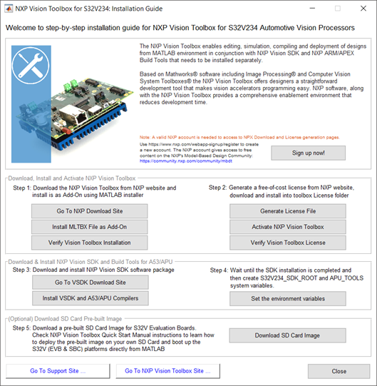

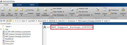

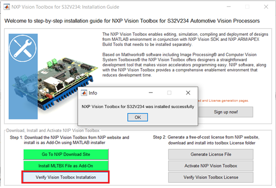

5. Run the " NXP_Support_Package_S32V234" command in your MATLAB console to start the Installer Guide.
6 .The NXP Support Package for S32V234 - Installer Guide User Interface is started

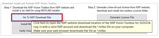

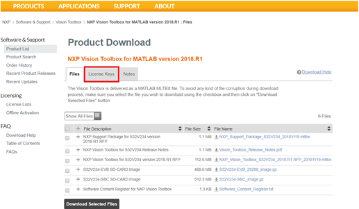

7. Click on “Go To NXP Download Site” button
8. Download the NXP Vision Toolbox for S32V234 version 2018.R1.RFP using "Download Selected Files" option
9. Click on “Install MLTBX File as Add-On” button select the file to start the install process

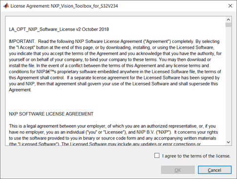

10. Indicate acceptance of the NXP Software License Agreement by selecting “I agree to the terms of the license” to proceed
11. Check if the NXP Vision Toolbox is installed correctly on your MATLAB environment by simply clicking on “Verify Vision Toolbox Installation” button

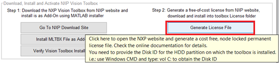

12: Press on “Generate License File” button to generate a license file

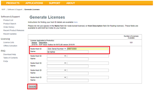

13. Select "License Keys" tab
14. Verify if the correct tool and version are identified and then check the box and click on “Generate” button
15. Select Disk Serial Number or Ethernet address as the “Node Host ID”. If you do not know your Disk Serial Number nor the Ethernet address then check the link available on this page with details about License Generation.

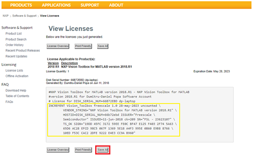

16. Click on “Generate” button to get the license. Verify if the information is correct: Toolbox version, expiration date, Node Host ID
17. Use the “Activate NXP Vision Toolbox” option to make sure the license is copied correctly in the appropriate toolbox location
18. Check if the license file is installed correctly by using the “Verify Vision Toolbox License” button. If everything is ok, then the Installer Guide will confirm the action
