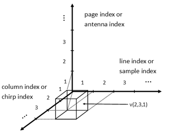

SPT INPUT DATA
Data received by the SPT is made of demodulated signal and can be organized as a 3 dimensional array in the following way: there is a page for each antenna, and each page contains a matrix where each column contains the samples of a chirp.
NOTE: In MATLAB we refer to the third dimension as pages. For example v(:,:,1) is the first page of v.
Fig. 2: SPT input data representation
% Number of bits used to retain the operands
NBITS = 16;
% Number of bins for histogram
B = 46;
% Maximum range that can be detected
max_range = 150;
% The radar can also detect the negative velocities and its range is in fact [-max_velocity, max_velocity].
max_velocity = 100;
% Number of samples per chirp
M = 512;
% Number of chirps
N = 256;
% Number of antennas
P = 4;
% We take as input the sum of two 3D sinusoids. This is the case when there are two objects in front of the radar.
% The two frequencies in the first dimension or the two frequencies of each chirp
fs1 = 150.5 / M;
fs2 = 100.5 / M;
% The two frequencies in the second dimension or the two Doppler frequencies
fc1 = -99.5 / N;
fc2 =  99.5 / N;
% The two frequencies in the third dimension
fa1 = 1.5 / P;
fa2 = 0.5 / P;
ts = (0:M-1)';
tc = 0:N-1;
ta(1, 1, : ) = 0:P-1;
ts = repmat(ts, [1, N, P]);
tc = repmat(tc, [M, 1, P]);
ta = repmat(ta, [M, N, 1]);
% SPT input data
input_data = sin(2*pi*(fs1*ts + fc1*tc + fa1*ta))+cos(2*pi*(fs2*ts + fc2*tc + fa2*ta))+randn(M, N, P);
input_data = input_data / max(max(max(input_data)));
% SPT input data as 16 bits fixed-point data
input_data_rs = round_and_saturate(input_data, NBITS);
