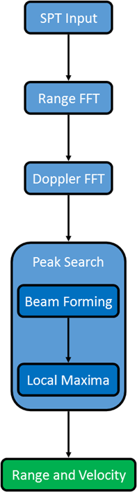

DATA PROCESSING FLOWCHART
Data flow of the MATALB script is presented in the following diagram. The input data for the local maxima detection algorithm is obtained from the SPT input data by applying range FFT, Doppler FFT, and beam forming.
Fig. 2: Data processing flowchart

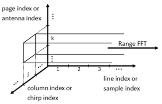

SPT INPUT DATA
Data received by the SPT is made of demodulated signal and can be organized as a 3 dimensional array in the following way: there is a page for each antenna, and each page contains a matrix where each column contains the samples of a chirp.
NOTE: In MATLAB we refer to the third dimension as pages. For example v(:,:,1) is the first page of v.
Fig. 2: SPT input data representation

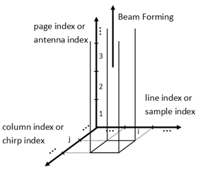

BEAM FORMING
Peak search detects the magnitude peaks of the matrix obtained from beam forming. The beam forming cancels the time delay between the signals of any group of two adjacent antennas and adds the resulted signals. This is accomplished performing an FFT for each page.
Fig. 5: Beam forming input data processing

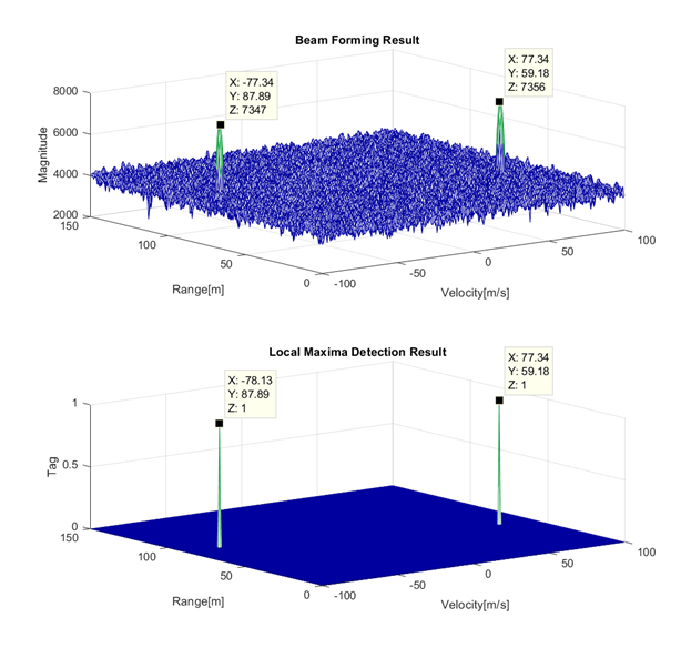

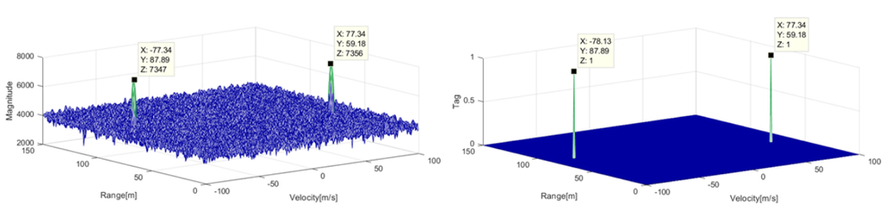

RESULT
The fist image below is the beam forming result which is also the local maxima detection input, and the second image below is the local maxima detection output.
Fig. 6: Input and output of Local maxima detection
