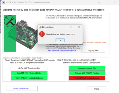

HI, I am trying to install the toolbox 1.7.1 patch(first time) but still not able to find valid license.
Please help.
1. Matlab Version used R2022a
2. Toolbox used (installed 1.7.1 from the patch given in previous threads)
3. Support Package used 1.8.0
4. License used 1.7.0
#Model-Based Design for SPT - Model-Based Design Toolbox for S32 SPT 3.x 1.7.0
#for Bodhit Kumar Gupta Software Account
# License for DISK_SERIAL_NUM=729B591F myPC
INCREMENT MBD_Toolbox_SPT freescale 1.0 12-jun-2034 uncounted \
VENDOR_STRING="Model-Based Design Toolbox for S32 SPT 3.x \
1.7.0" HOSTID=DISK_SERIAL_NUM=729b591f ISSUER="Freescale \
Semiconductor" ISSUED=20-apr-2025 ck=198 SN="FSL - 16235731" \
TS_OK SIGN="1CDD 3A4B 3801 A650 E555 251E 85CC BDD3 9830 6754 \
1B79 7015 D451 3312 3932 003B 12F4 9E19 849D 4739 96A3 07D2 \
DE92 2D32 9868 F401 6F5E 8AE0 22DE 8992"
Am i missing anything ?
TIA !

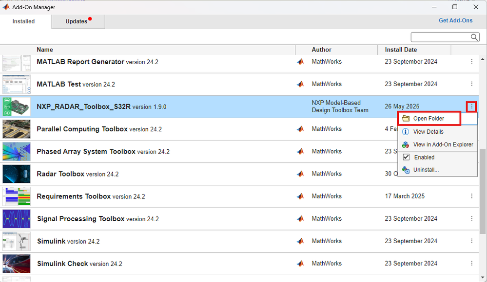

From what I can see the toolbox cannot find the license file. You should copy the license file in the folder call license from the toolbox directory.
To copy the license file in the appropriate folder you can follow the next steps:

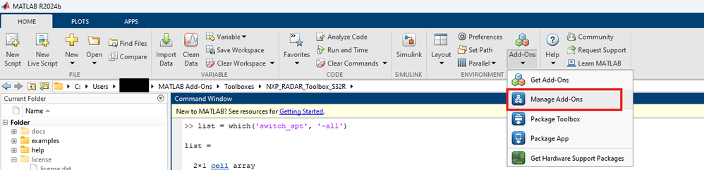

  1. Select HOME->ENVIRONMENT->Manage Add-Ons which will open an window with the installed Add-OnsScreenshot 2025-05-26 184315.pngScreenshot 2025-05-26 184315.png
  2. Look for NXP_RADAR_Toolbox_S32R. On the right you can find three dots, from where you can open the directory that contains the toolboxScreenshot 2025-05-26 185211.pngScreenshot 2025-05-26 185211.png
  3.  Copy the file with the license in the license folder. The license file must be name license.dat.Screenshot 2025-05-26 183819.pngScreenshot 2025-05-26 183819.png
Another issue I can see is having multiple instances of the toolbox installed. To check that run (See image above):
list = which('switch_spt', '-all')
In case you have more instances installed the list will contain distinct paths to the file switch_spt. In order for the SPT toolbox to work properly you should have only one instance of the toolbox installed.
To check if the license check is working now run: switch_spt.
If no error was throw the license file is good, otherwise please write us the error.
