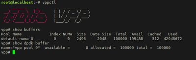

I have started VPP on my lx2160 board, and iperf tests were done.Some problems were found during testing:
1、the value of Used, it doesn't look right.
vpp# show buffers
Pool Name Index NUMA Size Data Size Total     Avail Cached Used
default-numa-0 0 0     2496 2048        100000 199488 512 42948672
2、I just tested 5m, and allocated quickly reached its maximum value, making it impossible to receive any more packets
iperf -u -c 10.8.19.178 -p 2152 -i 1 -b 5m -t 99999
vpp# show dpdk buffer
name="vpp pool 0" available = 0 allocated = 100000 total = 100000
3、The vpp_main thread is prone to crash when testing larger amounts of traffic,check the core with gdb and it's not the same every time.

4,572 Views
dunk
I faced the same issue when simply injecting the *slow protocol* Ethernet packet to the VPP.
You can watch the buffer "show dpdk buffer" to see the buffer is not *freed* while dealing with every *slow protocol* packet coming throught the VPP ports.
When the buffer is all allocated, VPP will then crash.
4,562 Views
Blue_Sky1
Yes, I used show dpdk buffer later, but ran into another problem.When I use iperf for udp traffic testing, even if the test traffic is small, the dpdk buffer runs out very quickly (having modified the buffer's number to be larger) and no longer receives data.
