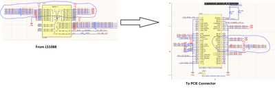

Hi everyone,
I have a custom ls1088 board. I want to use pcie1(serdes2 laneA) connection as a wifi module. I change serdes registers based on "QorlQ ls1088 Referance Manual". Serdes2 protocol number is 20(decimal). Pci is working in RC mode. I dont change anything in dts file. (I try to change the pcie status but it doesnt effect anything, it always opens all pci buses)
my custom board dts is working correctly, i am just trying to add pci connection as a extra.
in u-boot i tried to check the pci connection and i saw something like that ->
=> pci
Scanning PCI devices on bus 0
BusDevFun VendorId DeviceId Device Class Sub-Class
_____________________________________________________________
00.00.00 0x1957 0x80c0 Bridge device 0x04
i think that it is just the pci-bridge, not wifi connection. Is my configuration right?

We solved the problem. Problem was in hardware. thank you for your helps.

ammtgunn

I'm sorry for the late reply. here is the schematic and u-boot log .

ufedor
Please provide the processor connection schematics as PDF.

ufedor
Schematics is required.

ufedor
Please provide the processor connection schematics as PDF and U-Boot log showing RCW.
