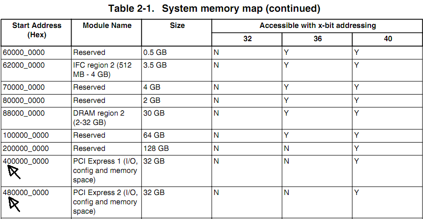

Now I have a problem about pcie dts. In ls1021a.dtsi, have a pcie description:
pcie@3400000 {
                        compatible = "fsl,ls1021a-pcie", "snps,dw-pcie";
                        reg = <0x00 0x03400000 0x0 0x00010000   /* controller registers */
                               0x40 0x00000000 0x0 0x00002000>; /* configuration space */
                        reg-names = "regs", "config";
                        interrupts = <GIC_SPI 181 IRQ_TYPE_LEVEL_HIGH>,
                                     <GIC_SPI 183 IRQ_TYPE_LEVEL_HIGH>; /* aer interrupt */
                        interrupt-names = "pme", "aer";
                        fsl,pcie-scfg = <&scfg 0>;
                        #address-cells = <3>;
                        #size-cells = <2>;
                        device_type = "pci";
                        num-lanes = <4>;
                        bus-range = <0x0 0xff>;
                        ranges = <0x81000000 0x0 0x00000000 0x40 0x00010000 0x0 0x00010000   /* downstream I/O */
                                  0x82000000 0x0 0x40000000 0x40 0x40000000 0x0 0x40000000>; /* non-prefetchable memory */
                        msi-parent = <&msi>;
                        #interrupt-cells = <1>;
                        interrupt-map-mask = <0 0 0 7>;
                        interrupt-map = <0000 0 0 1 &gic GIC_SPI 91  IRQ_TYPE_LEVEL_HIGH>,
                                        <0000 0 0 2 &gic GIC_SPI 188 IRQ_TYPE_LEVEL_HIGH>,
                                        <0000 0 0 3 &gic GIC_SPI 190 IRQ_TYPE_LEVEL_HIGH>,
                                        <0000 0 0 4 &gic GIC_SPI 192 IRQ_TYPE_LEVEL_HIGH>;
                pcie@3500000 {
                        reg = <0x00 0x03500000 0x0 0x00010000   /* controller registers */
                               0x48 0x00000000 0x0 0x00002000>; /* configuration space */
                        interrupts = <GIC_SPI 182 IRQ_TYPE_LEVEL_HIGH>,
                                     <GIC_SPI 184 IRQ_TYPE_LEVEL_HIGH>; /* aer interrupt */
                        fsl,pcie-scfg = <&scfg 1>;
                        #size-cells = <2>;
                        num-lanes = <4>;
                        ranges = <0x81000000 0x0 0x00000000 0x48 0x00010000 0x0 0x00010000   /* downstream I/O */
                                  0x82000000 0x0 0x40000000 0x48 0x40000000 0x0 0x40000000>; /* non-prefetchable memory */
                        interrupt-map = <0000 0 0 1 &gic GIC_SPI 92  IRQ_TYPE_LEVEL_HIGH>,
                                        <0000 0 0 2 &gic GIC_SPI 189 IRQ_TYPE_LEVEL_HIGH>,
                                        <0000 0 0 3 &gic GIC_SPI 191 IRQ_TYPE_LEVEL_HIGH>,
                                        <0000 0 0 4 &gic GIC_SPI 193 IRQ_TYPE_LEVEL_HIGH>;
In reg property, why does configuration space set 0x40 or 0x48? what's mean of the address of 0x40 or 0x48?

If you look from the root of the tree you can see that parent of these nodes has
#address-cells = <2>;
#size-cells = <2>;
So in the <reg> we need 4 32-bit values for single pair address : size on this bus. So each <reg> specifies that PCIe@340000 node occupies <0x0 0x00002000> = 0x2000 bytes at address <0x40 0x00000000> = 0x4000000000 while the second PCIe occupies 0x2000 bytes at address 0x4800000000. The same PCIe@340000  <range> refers to the addresses <0x40 0x40000000> = 0x4040000000 and 0x4000010000 , while PCIe@350000  <range> refers to the addresses 0x4840000000 and  0x4800010000
 It is in accordance to the LS1021A memory map. The LS1021A reference manual table 2-1 shows
