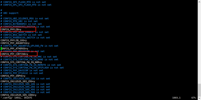

Is your PHY chip AR8033? Have you enabled the following in configs/lx2160ardb_tfa_defconfig
CONFIG_PHYLIB=y
CONFIG_PHY_ATHEROS=y
13,308件の閲覧回数

yes my  PHY chip is AR8033。
i have enabled the following in configs/lx2160ardb_tfa_defconfig
13,297件の閲覧回数

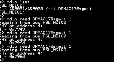

You could use mdio read command to check the status of a SGMII link.
=> mdio list
FSL_MDIO0:
4 - AR8031/AR8033 <--> DPMAC17@sgmii
FSL_MDIO1:
=> mdio read DPMAC17@sgmii 1
Reading from bus FSL_MDIO0
PHY at address 4:
1 - 0x7969
The link partner link status bit is in Register #1 on the PHY. The 'Link Status' bit is bit #2 (from the left) of the last nibble. In your above result, the nibble of interest is "9" (d = b'1001'), and therefore the 'Link Status' = 0, which means 'link download'. If the link is up,  this bit would be a "1," and we would see 0x796d.
So on your custom board the SGMII link status is download, please check the probable hardware issue.
13,282件の閲覧回数
muaxi8
Contributor V
The second read was link.

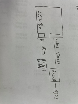

  1. Can you share share schematic?
13,264件の閲覧回数
muaxi8
Contributor V
1. Do ping works on MAC18?
Re:
Dpmac18 (EC2) cannot be tested because it is not connected to any PHY.We only used mac17, our SERDES2's SGMII17 was connected to the AR8033, and our EC1 was connected to the KSZ9896 switch chip via RGMII.I think this might be a problem, so I'm just going to debug SGMII and leave RGMII alone for now
(a). Clock configuration shown in uboot is not as per the selected protocol.

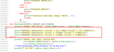

Re: The clock configuration is printed directly in the source code, we did not remove, serdes2 clock is actually 161.xxxMhz.
(b). PCA: failed to select proper channel
Re: Our custom board is not using PCA9547 (I2C MUX, level 1), so there is this error。
 schematic:
链接:https://pan.baidu.com/s/14edfW8yig7c-qZyYTLk7xQ
提取码:2345

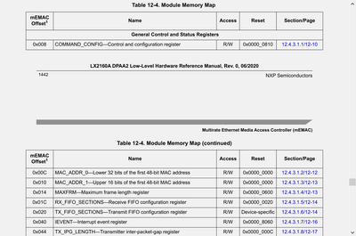

Thanks for update. Can you please view more registers to check if read is working correctly?
Please refer register details in LX2160ARM Rev0 07/2020 section 26.9.2 SGMII Registers (Please read register 0,2,3 also)

=> mdio list
FSL_MDIO0:
FSL_MDIO1:
PHY at address 4:
1 - 0x796d

Please refer "Table 51 MAC Capabilities" This table shows different MAC address and there capability.
I understand customer is using MAC 17 hence to reading all the register customer needs to use address "8C4_7000h"
Syntax for Clause 45: (Please read status register multiple times)
go 0x80300000 read <mac address> <MMD device> <register>
go 0x80300000 read 0x8c0b000 3 1
0x8c0b000= MAC address
3->  Device: PCS address  (Table 287. Device Address Overview)
1-> PCS status register
Syntax for Clause 22: (Please read status register multiple times)
read <mac_addr> <mmd always 0>  <reg addr>  <any value: e.g. 0 this is a switch that tells its clause 22>
For example to read control register
go 0x80300000 read 0x8c47000 0 0 0
To Read status register
go 0x80300000 read 0x8c47000 0 1 0
Do customer is able to boot linux on board?
does ping don't work on Linux?
Can you detail about your setup?
Please use MAC17 address "8C4_7000" instead of 0x8c0b000.
