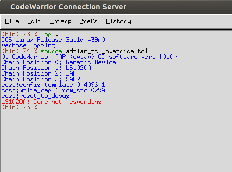

addiyi
Try using in ccs the script attached, but make sure the rcw registers values are adapted  for you board.

Hi Adrian,
  Here is the output:
10,709 Views

Any advice on connecting to our board, without using the hard-coded RCW values in the JTAG ini file?  I believe we are loading our RCWs from flash on RESET.  The RCWs from the JTAG .ini and the RCWs in flash differ by only a few bits - particularly the rcw[DDR_REFCLK_SEL] field.  When we try to connect without the hard-coded RCW, we most often get "core not responding"
We kind of suspect that the problem is that we're connecting via JTAG with the hard-coded RCW value 0x9A. It appears we are loading our RCW values from QSPI flash, but cannot seem to connect via JTAG in anyway unles we have the hard-coded RCW value set up in the JTAG ini file.

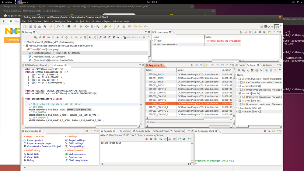

We've done some more digging and found that all of the other components in the CCSR space seem to read back just fine.  Even the reserved space right up to 0x0107FFF0.  But the first read of 0x01080000 will cause a scan timeout.  Is there anything that could cause the DDR controller to lock up such that it can't even respond to a JTAG read of its registers?

jasonhendrix
Contributor V
Hi Alexander,
This is a straight read of a memory mapped DDR controller register.  You can't quite see the full addresses in the picture I attached, but they match the datasheet addresses for the DDR controller i.e. 0x0108_0000
10,709 Views
addiyi
Please make sure core is suspended. CW will do all accesses via core and if core is running, you will get "Scan timeout" message.
Adrian
10,709 Views
jasonhendrix
Contributor V
Hi Adrian,
It's not shown as suspended in the picture I attached, but the results are the same even when it is suspended.
