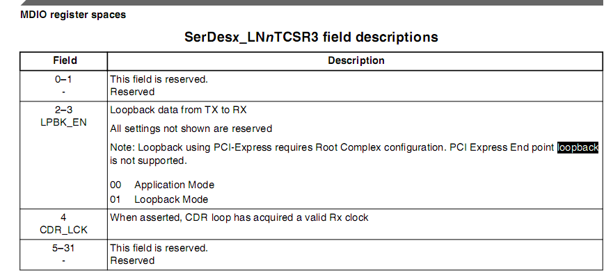

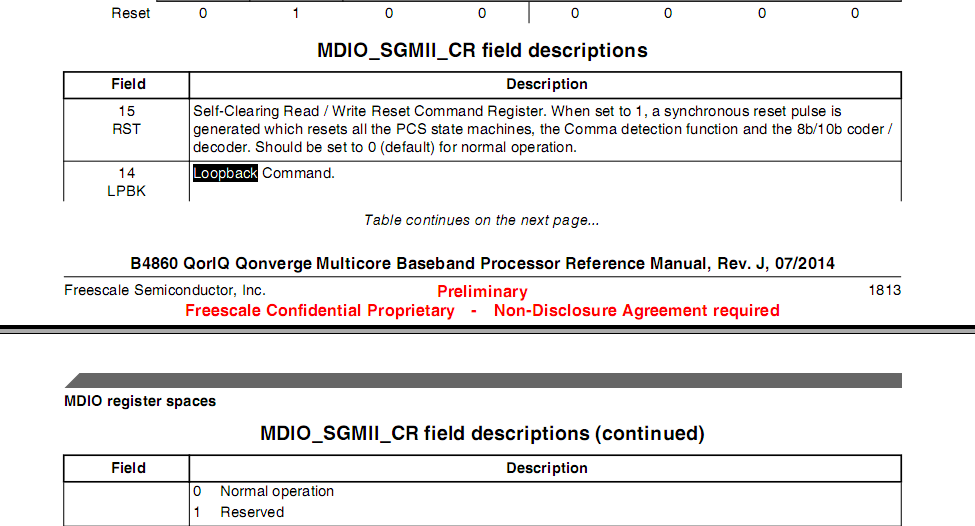

from datasheet we know serdes can loopback from tx to rx.
but we need loopback from rx to tx.can B4860 support this loopback mode?
1,967 Views
alexander_yakov
By loopback from RX to TX it is assumed external signal, coming to RX, should be returned back to TX?
No, this loopback from RX to TX is not supported.
